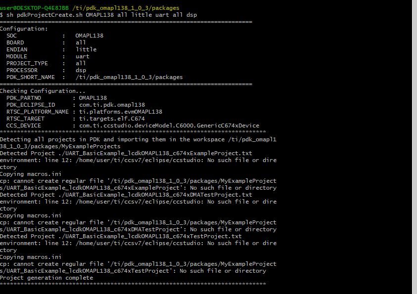

    I executed pdksetupenv.sh and it was OK. I also executed pdkProjectCreate.sh, but the folders were not created and the batch file threw error Unknown product ID and system cannot find path specified. The MyExampleProjects was created but was not populated correctly.

    Attached is the error window

    I suspect this is a problem with the installation of the SDK. Can you try a fresh installation?
    Download the binary installer and then execute:
    chmod +x ti-processor-sdk-rtos-k2g-evm-04.01.00.06-Linux-x86-Install.bin
    ./ti-processor-sdk-rtos-k2g-evm-04.01.00.06-Linux-x86-Install.bin
    And follow the instructions in the wizard. I advise you to install the SDK in ~/ti/ as suggested by the installation wizard.
