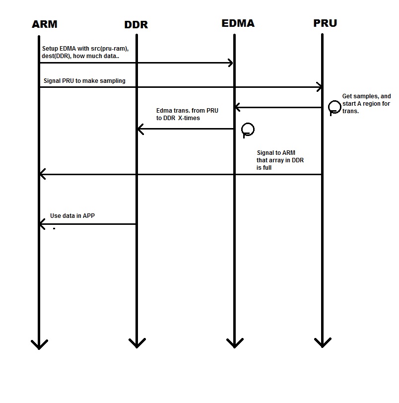

    2.) For better understanding of issue let me explain how system should look like.
    ARM code:
    - PRP driver
    - TimeSync
    - TCP
    - My custom tasks for HW(communication with PRU-ICSS0)
    - My custom tasks for calculating data from PRU-ICSS0 and sending it over TCP/UDP...
    PRU-ICSS1:
    -TI bin. code for PRP  (Use L3 and PRU RAM)
    PRU-ICSS0:
    - My custom code: Get samples from external sensors and send data to ARM.
    I think you miss understood. I didn't plan to modify PRP driver or PRU-ICSS1 code...
    For now I made "my HW tasks" and PRU-ICSS0 code. In general it work, but is too slow.
    Now PRU (ICSS0) copy data on L3 and ARM copy form L3 to DDR... but too many data and ARM is too slow with copying. If I wand PRU to copy data directly to DDR, latency is to big and PRU miss events for real time operations. So idea is to use EDMA to copy data rom PRU RAM to DDR.
    Goal is: ARM setup EDMA (src,dst,len), PRU trigger transfer chunks of data when data are ready in src. array (from sensors).. When X number of samples is captured PRU trigger ARM to use data in DDR.
    So Garrett.... Here is my question:
    As you can see from picture, PRU need access to EDMA, My tasks need access to EDMA and also TimeSync tasks use EDMA (part od PRP code packet).
    What is most elegant approach for "multi" processor EDMA use? How I can "pend" semaphore with PRU? Do I need check semaphore with PRU if I want just start partial transfers on chanell (setup is made buy ARM)?
    Regards, Mare
  • Hi Mare,
    1) edma3init() is called in TimeSync_edmaConfig(), thus the EDMA handler is the same timeSyncHandle->edmaConfig->gEdmaHandle even though you try to setup a second EDMA channel for data copy. "edma3init should be called once and the handler should be used by both the threads to request the channels with their own callback functions." see the thread - e2e.ti.com/.../126883.
    2) OK, now I understand your use case. I think you should be able to achieve this by manually trigger the EDMA transfer from PRU by writing to the event set register, see TRM 10.3.4.1.2 Manually Triggered Transfer Request, and EDMA3_DRV_TrigMode in EDMA3_DRV_enableTransfer() API.
