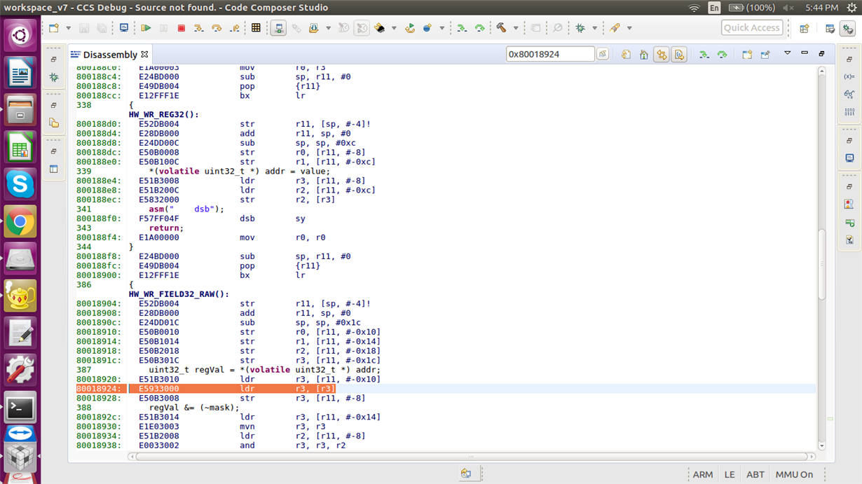

    I tried to port the above example from pdk_am335x_1_0_8 to etherCAT example application.
    But while configuring ADC clock an execption occurred.
    TSCADCClkDivConfig (pCfgAdc->instAddr, pCfgAdc->modClk, pCfgAdc->afeInClk);
    parameters given:-
    /* Macro representing the module clock of TSCADC. */
    #define TSCADC_MODULE_CLOCK (24000000U)
    /* Macro representing the AFE clock of TSCADC. */
    #define TSCADC_AFE_CLOCK (3000000U)
    /* Macro representing the base address of TSCADC module. */
    #define TSCADC_BASE_ADDR (0x44E0D000U)
    I am attaching screenshots of CCS disassembly.
    TSCADCClkDivConfig() is a function implemneted in tsc_adc_ss.c, it does a simple math division, then write the results into a register using HW_WR_FIELD32====>HW_WR_FIELD32_RAW. This is a common routine used by many functions. How this caused an exception? Read the value of address r3 into r3?
