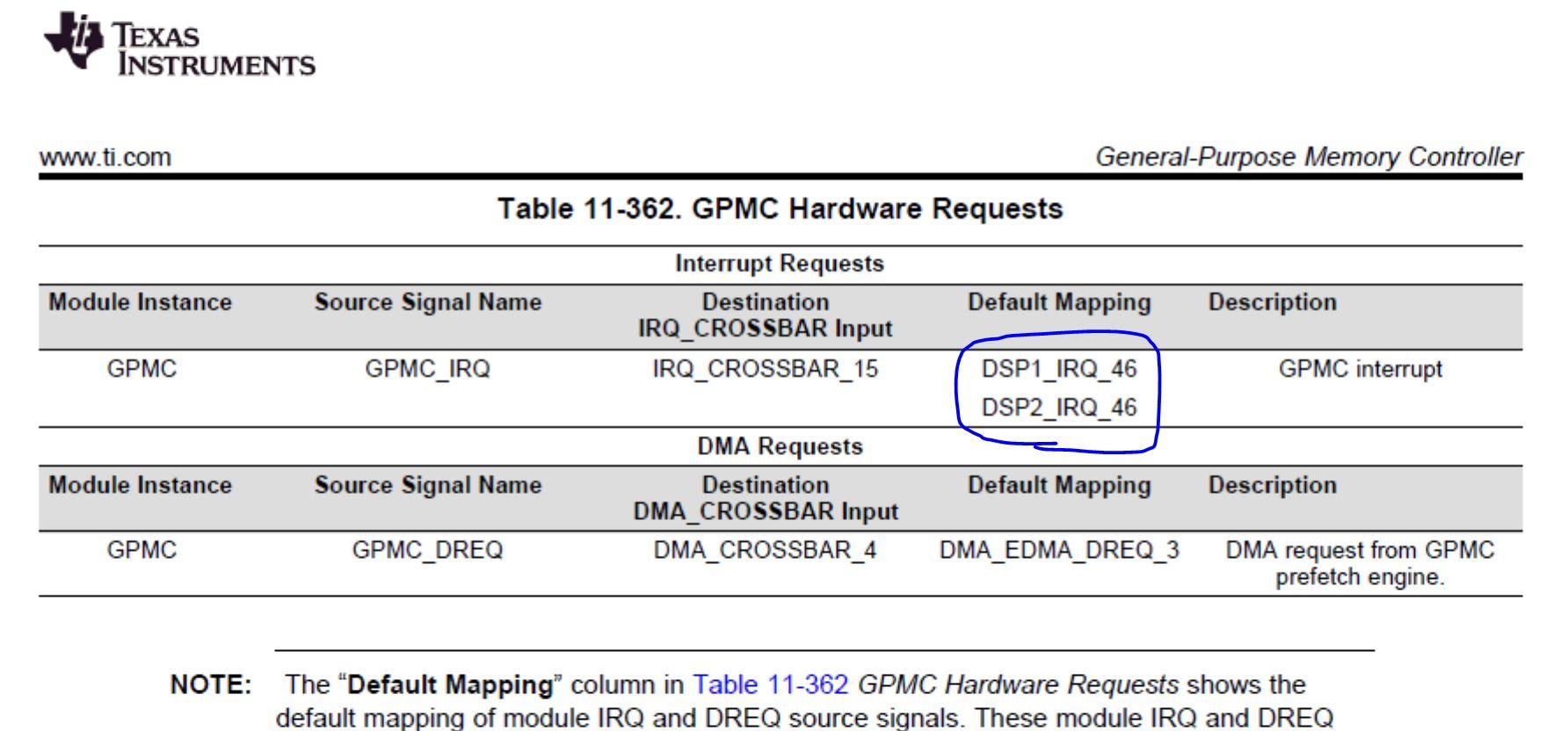

    i have a confuse about the spec like attached page 4085 , mention that
    GPMC_IRQ  >> IRQ_CROSSBAR_15 >> DSP1_IRQ_46 >> GPMC interrupt
    so i use DSP1_IRQ_46 as the interrupt .
    that is my misunderstanding ?
    or do you have any comment for the interrupt number and source ?

  • Hi Brian,
    You can connect any interrupt source to any CPU using the crossbar.
    This is the default mapping for DSP1 and DSP2.
    DSP mapping makes connection between GPMC and DSP but we need a connection between GPMC and IPU.
    Hence you need to do the below crossbar mapping:
    GPMC_IRQ >> IRQ_CROSSBAR_15 >> IPU1_IRQ_x >> GPMC interrupt
    Rishabh
