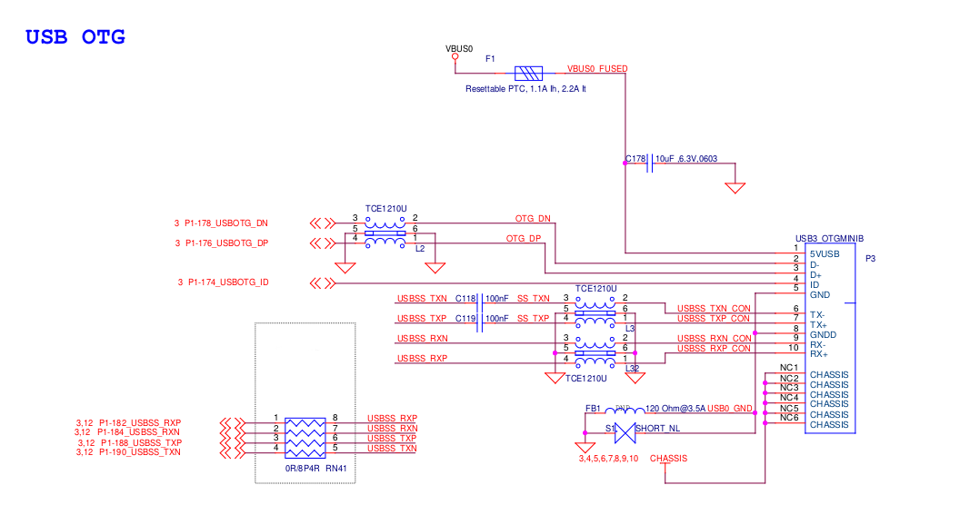

  • Nikunj,
    Please provide the USB portion of your schematics, especially the section which shows how the VBUS line is fed from the USB receptacle to the SoC.

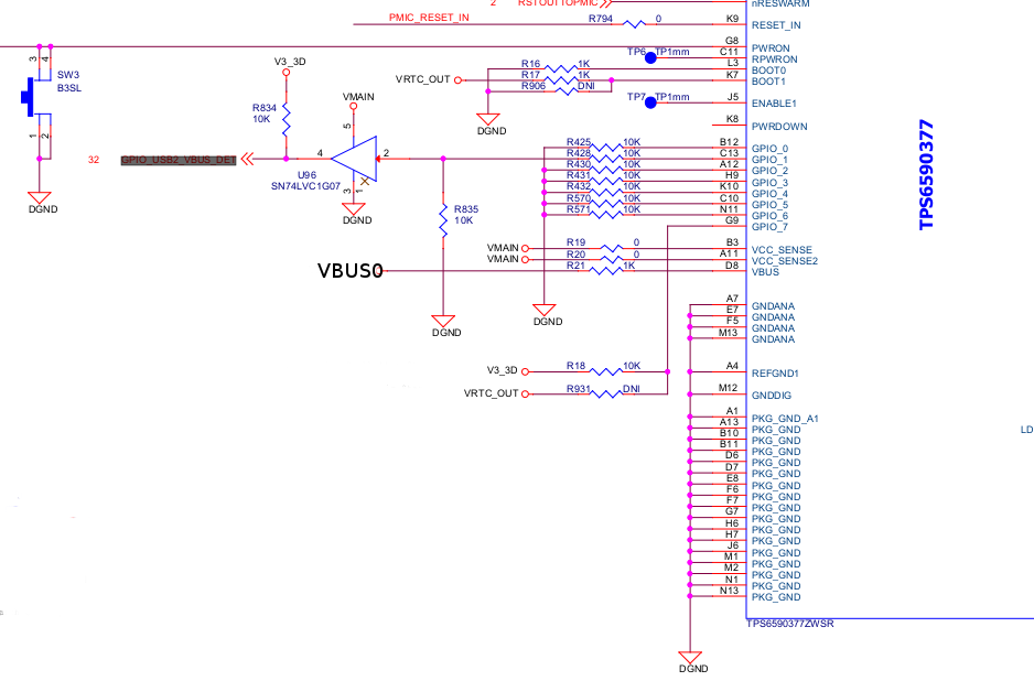

  • Hello Everyone;
    Please check above snapshots of schematic. please let us know if required more information.
    Thanks & Best Regards;
    Nikunj Patel
  • Where are signals VBUS0 and VBUS0_S connected to? I need to know how the VBUS pin of the P3 is connected to the SoC. Please provide all the details.
    Side comment: I see the two outputs of RYC8220 are VBUS0_S and VBUS1, are you trying to use a single power switch for two usb ports? If so, it is a very bad idea.
  • Sorry for late reply;
    Please check the above Schematic portion of VBUS0 connection.

  • Nikunj Patel said:
    extcon_usb1: tps659038_usb {
                compatible = "ti,palmas-usb-vid";
                ti,enable-vbus-detection;
    I guess the signal GPIO_USB2_VBUS_DET goes to a GPIO pin on AM57x? then you need to specify that GPIO in the extcon_usb1 node above.
    It seems your USB design is very close to TI AM571x IDK EVM, so please review the EVM schematics and am57x-beagle-x15-common.dtsi for how the VBUS signal is fed to the SoC.
  • Hello Bin Liu;
    Thanks for your reply;
    Yes in TI EVM this pin connected to the AM5718 GPIO.
    but in our board this pin does not connect to any GPIO pin of AM5718.
  • Nikunj,
    Please follow the EVM design to assign an AM57x GPIO pin to connect to your GPIO_USB2_VBUS_DET signal and specify the GPIO in the extcon_usb1 node in the DTS file.
    The USB driver has to know the disconnect from the USB host by receiving the GPIO event.
