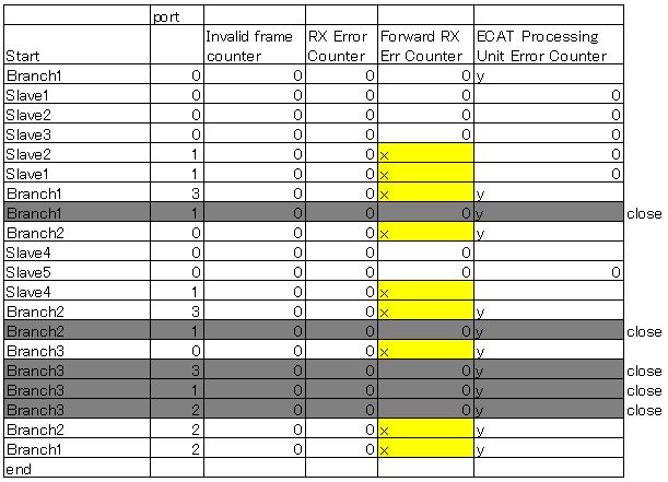

Are "RX Error Counter" and "Forwarded RX Error Counter" of TI ESC the same as the specifications of the following links?
https://www.pcb-3d.com/wordpress/wp-content/uploads/BGA128C80P12X12_1000X1000X120_JEDEC_MO-205_Beckhoff_10mmX10mm_TFBGA_128balls_ET1100.pdf
p.I-85 : 14.2 Errors and Forwarded Errors
The ESCs distinguish errors initially detected by an ESC and forwarded errors detected by a previous ESC. This is useful for error location when interpreting the RX Error/Forwarded RX Error counters. The first device detecting an error (e.g., a CRC error or an RX Error of the physical layer), will discard register operations and count a port error (0x0300-0x0307). The outgoing frame gets a special marking, consisting of one extra nibble added after the (invalid) CRC. A device receiving a frame with a CRC error and an additional nibble will also discard register operations, but it will count one Forwarded RX Error instead of a normal port error. NOTE: A forwarded error is sometimes called “green error”, the initial error is sometimes called “red error”. A physical layer RX Error is always a “red error”, because it could not have been forwarded.

    Is the error condition that you are seeing occur when the an error is occurring in the when the Error frame (without SFD) arrives at the IN or the OUT port of a slave?
     David
    Yes. When an error frame arrives, the Forward RX Err of the IN port remains 0,
    The Forward RX Err of Out port was counting up.
    Is this behavior correct?
    I would like to know why Forward RX Err does not count up at the IN port.
    Yellow block is Forward RX Error.

    To help us understand where is the error source - could we get a couple of additional pieces of information?
    The error counter values for all the slaves (0x300-0x30C ESC registers) ?
    If you have a passive sniffer like Hilscher netanalyzer or Beckhoff TAP, could you provide a wireshark log?

  • Hi Sask
    We notice that in the first file log_verification1.pcapng, after a certain point (frame 148), none of the frames return back to master.
    In the second file, from the very beginning, none of the frames return back to the master. It looks from the logs that one of the boards on the forward path is not forwarding the frames at all leading to frame drop.
    To help us understand the data -
    1. Are the two log files taken during the same test or all the boards were reset before taking the second log?
    2. What are the error counter values on each board when you see this issue?
    3. What version of the EtherCAT driver and firmware are they using?
    For example are you using PRU-ICSS-ETHERCAT-SLAVE 01_00_05_00 with the firmware that came with this release
    As described in the release notes - this release uses firmware build 1.4.236 .
    There was a mistake in the information described the other day. The following is the problem now.
    The customer tested in the above connection state.
    And the log acquired in this connection state is log1.zip.
    log1.zip
    The error counter value is as follows.
    Number of error occurrences   x < y
    ECAT Processing Unit One Error Counter register per 1ESC. Not for each port.
    Since the ECAT Processing Unit Error Counter counts when receiving packets other than ECAT, it is presumed that this is the problem of Forward RX Err Counter.

  • Hi Saski
    I am sorry - I was not clear in one of the questions.
    1) What version of the EtherCAT slave software is your customer using?
    - for example is it
    PRU-ICSS-ETHERCAT-SLAVE 01_00_04_00
    SYSBIOSSDK-IND-SITARA v02.01.01.02
    SYSBIOSSDK-IND-SITARA v02.01.03.02
    or is it another version?
    2) Are they using the PRU firmware that is contained in that release or are they using firmware from a different release?
