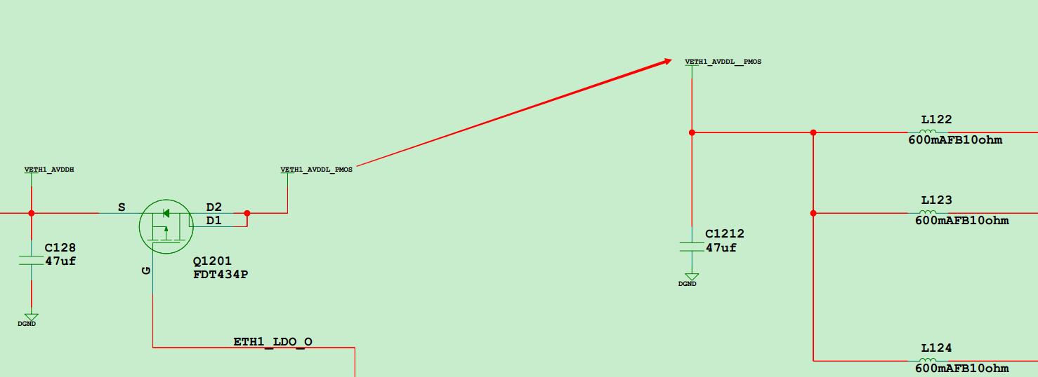

we searched someone have met the same problem,the link is this and this,but there's no method to solve it finally. The schematic as follow:
ETH1.pdfETH0.pdf
can someone help us to solve this problem?
  • Please check and make sure that your PHY's are set with different addresses. From the schematics they seem to be at the same MDIO address.
  • Hi Biser,we find out one bug in the both schematic ETH1.pdf and ETH0.pdf, in ETH1.pdf
    the left net name is VETH1_AVDDL_PMOS  but the right is VETH1_AVDDL__PMOS ,added one _  what a careless. the same problem in ETH0.pdf. now we modify by jumper on our board.we test all the voltage is right. as you say it seem to the same MDIO address. we have look over the datasheet of KSZ9031, the address is  set by PIN35 15 17 when power up,in our schematic, the PIN17 in both pdf are connected different,it is connected to DVDDH in ETH1.pdf by a resistor(on our board is 10k),and connected to DGND by a resistor(on our board is 1k),so the address should be different,we get the log as next picture,
    is this right.?the same id means wrong? what's the serious problem is after the console output end with up picture,whole the board power down,it seem to the net problem trig ti reset. does this trig by the same id?
