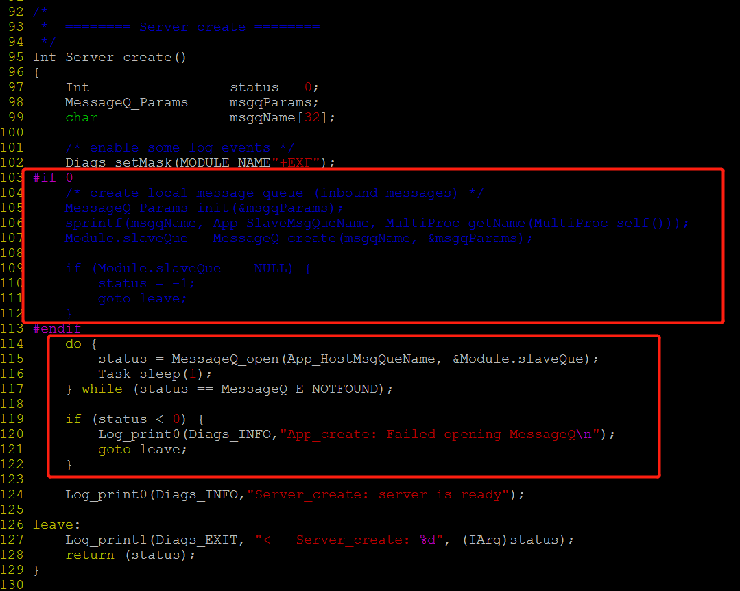

TI,Now I want to open the the host messageq que on the dsp1, so I add the code into the ex02_messageq/dsp1/Server.c Server_create() function.
do {
status = MessageQ_open(App_HostMsgQueName, &Module.hostQue);
Task_sleep(1);
} while (status == MessageQ_E_NOTFOUND);
if (status < 0) {
Log_print0(Diags_INFO,"Server_create: Failed opening MessageQ\n");
goto leave;
close the hostQue on the Server_delete() function like that:
MessageQ_close(&Module.slaveQue);
But when I run load the server_dsp1.xe66 into dsp1,run the "./app_host DSP1",the DSP1 will stop at MessageQ_open(App_HostMsgQueName, &Module.hostQue);
any suggestion?

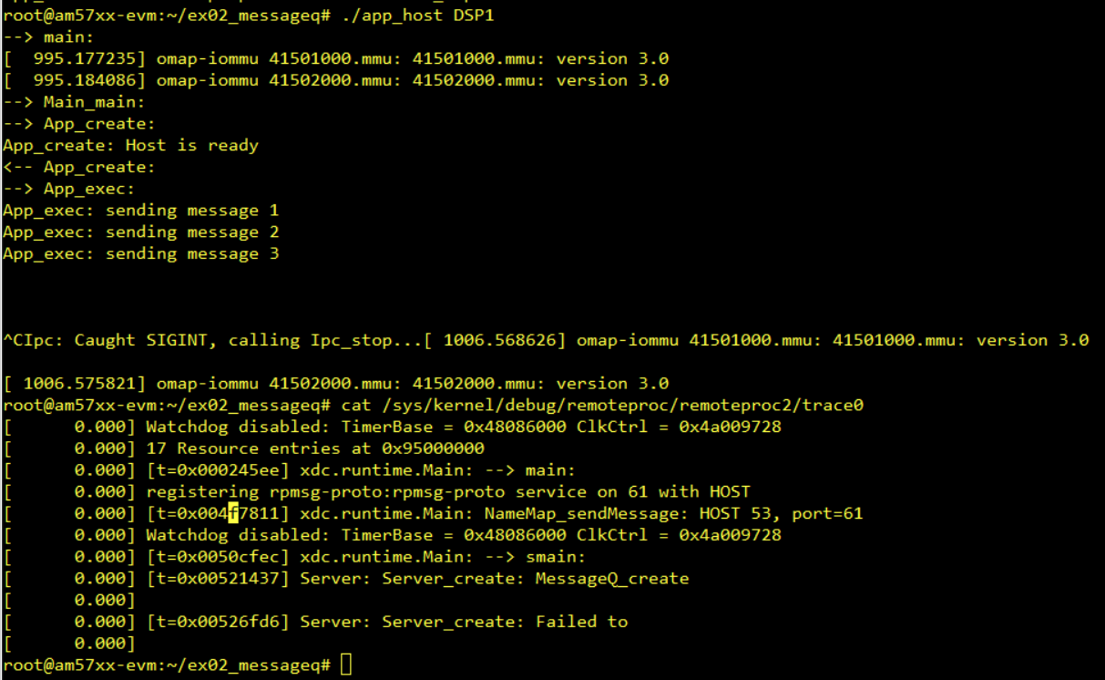

    Sahin, I am using SDK03.01,after set the environment variable IPC_DEBUG = 1,the log are below:

    root@am57xx-evm:~/ex02_messageq# cat /sys/kernel/debug/remoteproc/remoteproc2/trace0
    [      0.000] Watchdog disabled: TimerBase = 0x48086000 ClkCtrl = 0x4a009728
    [      0.000] 17 Resource entries at 0x95000000
    [      0.000] [t=0x000224cf] xdc.runtime.Main: --> main:
    [      0.000] registering rpmsg-proto:rpmsg-proto service on 61 with HOST
    [      0.000] [t=0x004154dd] xdc.runtime.Main: NameMap_sendMessage: HOST 53, port=61
    [      0.000] [t=0x0042bdf7] xdc.runtime.Main: --> smain:

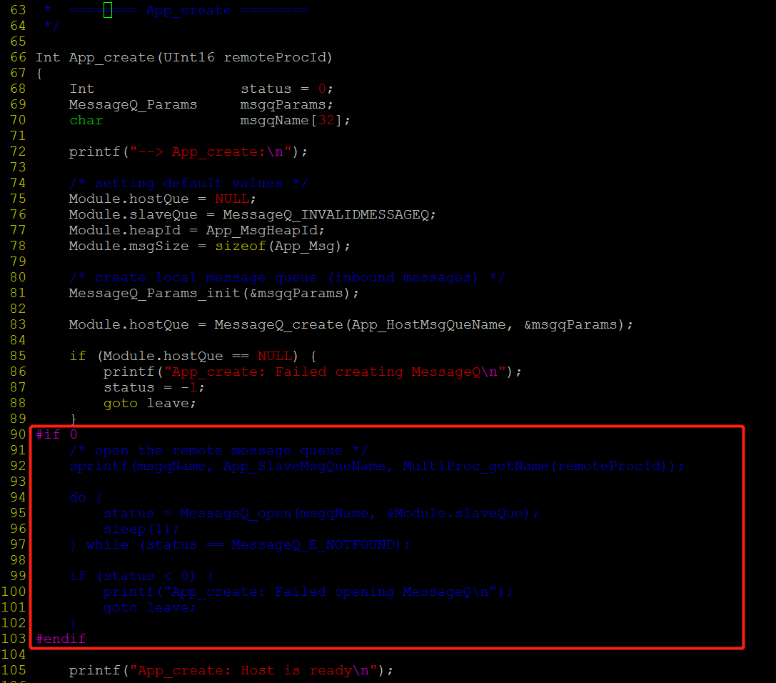

    the App_create function:
    the Server_create function are:
    BR,
    vefone
  • Hi vefone,
    I don't think you need to do a messageQ_open in your server_create function there. Simply do a messageQ_get when the time comes to retrieve a message.
    Refer to our ex02_messageQ example to see the order of the messageQ API's being used.
    Also, take a look at our user's guide for more details on the application flow.
    I hope this helps.
