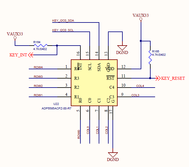

I am using battery operated using am335x. and i have touch, lcd, key provision i have.
how can i control the power management scenarios in our background application.
how to invoke my key for wakeup the processor. where should i call my key int in kernel.

You can use AM335x I2C0 to wakeup the AM335x device. But this feature is not enabled by default in linux kernel, you should develop/enable it. You can get example code from AM335x StarterWare package, where I2C0 is used for wake-up:
In TI linux kernel, by default we have the below wake-up sources:
1. UART/console
2. GPIO0 - One can wakeup from standby from any of the GPIO lines by pressing any button/key connected to a GPIO line
3. Touchscreen - Wakeup from standby mode is possible via internal TSC-ADC module. Pressing the touchscreen will cause a wake-up.
4. RTC
5. Timer
For adding I2C0, you can examine the StarterWare package and TRM chapter 21 I2C
