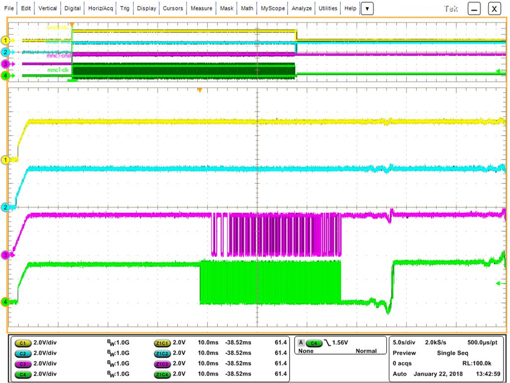

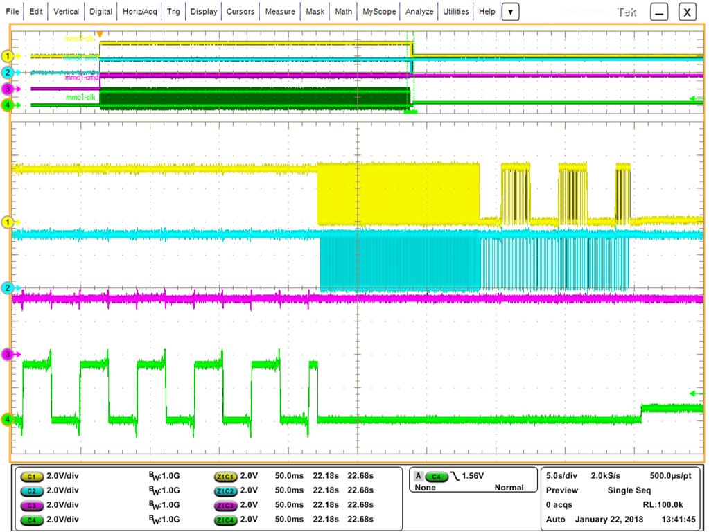

    yes it is around 20 seconds to change from 0 -> 1. (see screenshot below [yellow=mmc0-clk, lightblue=mmc0-cmd, purple=mmc1-cmd, green=mmc1-clk)
    Detail mmc1:
    Detail mmc0:
    C-characters will be printed 8 times each 20 seconds.

  • The toggle frequency of 100Hz doesn't make sense either. Do you mean that the MMC_CLK during the 20 sec in eMMC boot is toggling at 100Hz? It should start out at 400KHz, then switch to 12MHz.
    Is there any way they can connect JTAG during that 20sec and report the where the program counter is?
    James
  • Hi James,
    The MMC1_CLK starts with a frequency of 100kHz. With this frequency there is some kind of traffic on the MMC1 port. After certain amount of bytes it seems like the interface switches to a different mode what ends up in a stop of data transfer on the CMD line and lowering the frequency to something around 100Hz. In this state the MMC1 port stays nearly 20 seconds before the next boot source is switched to.
    JTAG interface can be connected to see where the program counter is.
    To make my statement meaningful the measurements will be done again but with a better granularity.
