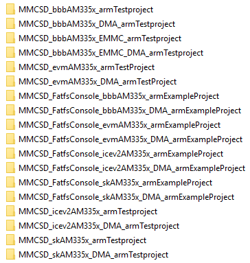

  • Takashi,
    Please use the Processor SDK PDK examples for MMCSD located at C:\ti\pdk_am335x_1_0_9\packages\MyExampleProjects
    Starterware isn't supported any longer in the SDK, so would not recommend going that route.
    Not sure which SDK you are working with at the moment. Please let me know if you need help getting the examples built in MyExampleProjects
    Lali
