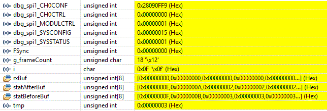

I'm using AM3358 - PRU1 to set up SPI1, and the data goes out D1 (MOSI) and appears at D0 (MISO), but all I ever read from RX0 is 0. I've looked at the very similar threads from bwilcutt and others, but they don't seem to end with an answer. I'm using CCS7.4.0.00015 on WIn10, with XDS110 debug probe.

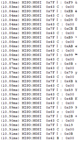

SPI1 sends 8 words x 32-bits, every 125 us. It looks like this:
The SPI decoder decodes this as below, which is what I expect.

After running the code below for a few seconds and then pausing the debugger, these are the results. The code initializes the IEP (for 125 us timing generation) and SPI1 (for data transfer). Then it waits in a loop for the timing comparison from the IEP. 8 words are written to the SPI Tx, and 8 words are collected back. Flag status before and after reading RX0 are saved, as well as the RX0 value. The SPI registers are fetched periodically (dbg_spi1_*) for debug reporting. Note that the rxBuf results are all 0.

  • Your SPI clock is pinmuxed as output only. It must be:
    pin 100 (PIN100) 44e10990 0000002b pinctrl-single
    See Note 1 below Table 24-4 in the AM335x TRM Rev. P.
