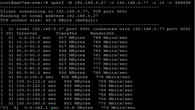

The eth0 can receive or send network package at 300Mb/s and the linux system can work well.
The eth1 also can receive or send network package at 300Mb/s and the linux system can work well.
However if we use the eth0 and eth1 together and the both ethernet card send or receive at 200Mb/s.
the eth1 will crashed and droped package and linux system will print watchdog time out error like below:

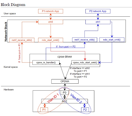

    My custom board is dual standalone emac mode and their CPDMA and skb buffers are common for both eth interfaces
    So we doubt whether it will have effect

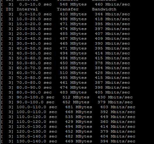

    We changed the ti_cpsw.descs_pool_size=4096 and we get some new test result:
    We use eth0 to do stream forwarding and use eth1(tcp methord) to iperf testing
    generally when the eth0 get to 400Mb/s, the eth1’s bindwidth will decrease to 320Mb/s.
    when the eth0 get to 300Mb/s, the eth1’s bindwidth will increase to 420Mb/s
    That is to say the total bindwidth for eth0 plus eth1 is 720Mb/s, if one’s bindwidth increased then anther one will decrease the bindwidth.
    So my question is how to increase the total bindwidth to 900Mb/s?
    regards

    Generally when the eth0's send bindwidth get to 400Mb/s, the eth1’s bindwidth will decrease to 320Mb/s.
    when the eth0'send bindwidth get to 300Mb/s, the eth1’s bindwidth will increase to 420Mb/s
    That is to say the total send bindwidth for eth0 plus eth1 is 720Mb/s, if one’s bindwidth increased then anther one will decrease the bindwidth.

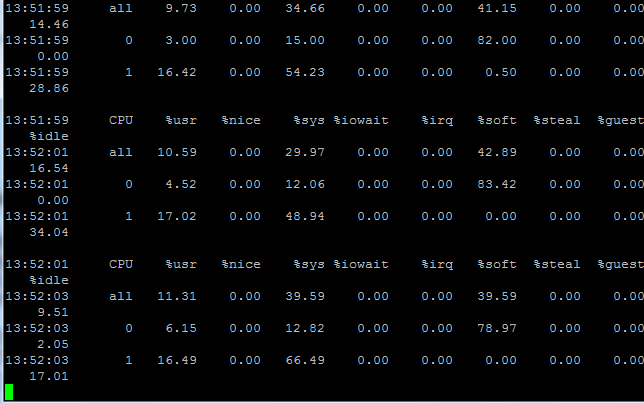

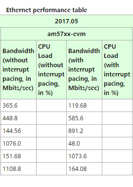

    We have enabled the interrupt pacing by the ethtool, but there is no use.

    3 We are so confusing about the CPSW.
    So we doubt whether it will have effect.

    Just now the total bindwidth of the eth0 and eth1 is 720Mb/s and we have test over 100 hours The stability is OK。
    we will test the patch and then tell you the resoult.
    My custom TCP application receive web camera stream(8Mb/s) and then copy it  to lots of stream (All the stream can be up to 400Mb/s), finally send these stream to (Windows)PC.
    We use iperf to test eth1, my iperf is a TCP client which send stream to the iperf server, the iperf server is a AM5728 board.
    So we mainly test the sending performance of the eth0 and eth1.

    mpstat -P ALL 2

    4 The below picture is my system load:

    We used one iperf to test the eth0 performance.
    The result is like below:

    We also used two iperf process to test eth0 and eth1.
    My server command is :
    iperf -B 192.168.0.77 -s -i 1 &
    iperf -B 192.168.1.77 -s -i 1 &
    According to the above test, eth0 is about 400Mb/s, eth1 is about 400Mb/s. the total bindwidth of eth0 and eth1 is 800Mb/s

    According to the below website, the ethernet eth0 TCP performance can get to 1108.8 Mb/s, But why my board can not get to this bitrate
    This page used to state how the test was performed, but the test is performed using iperf in dual mode which is sending and receiving simultaneously. The ethernet on the EVM is set to run in full duplex mode. The table is a summation of both transmit and receive. The test was done using only a single transmit thread and a single receive thread, combined they achieved a sum of 1109 bps.
    Your experiment is only doing send if I am correct, if you add -d to the iperf command line you might see these numbers. There is chance though that the number will be slightly less because you are using two ports.
