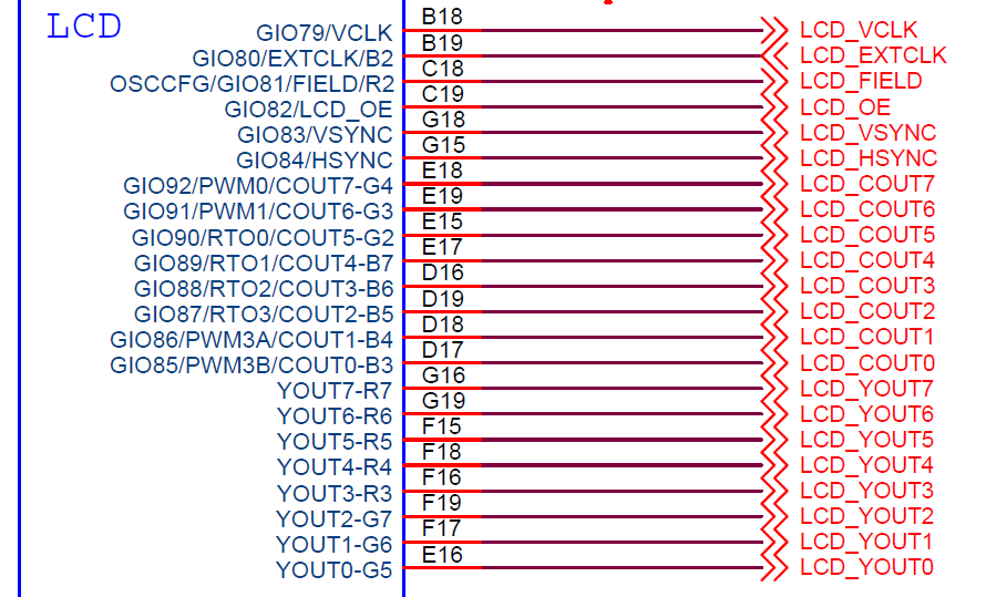

I would like to decode h.264 stream on LCD interface.
Our LCD interface only need HSYNC, VSYNC, RGB565 data.
So I'm using logicpd lcd device driver and our schematic is like folloings.
Drawing rectangle on Framebuffer works fine with below source code,
but decoding h.264 doesn't work. I modified demo/decode source code for us.
Can anyone give us any hint what is the problem please..??
Thank you for your readings.

Schematic  is....
dmesg from prompt says. ( I don't know why printk(KERN_DEBUG...) omits some prefix of logicpd device driver functions.)
