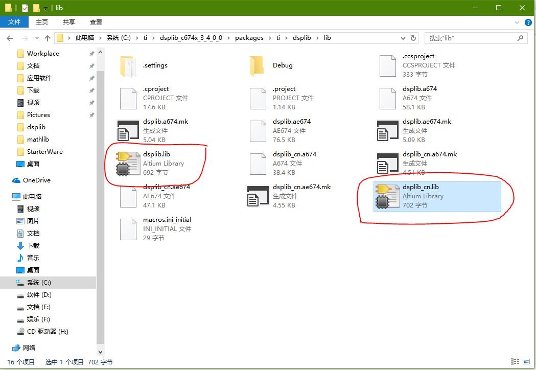

I am using TMS320C6748EZWTD4,The IDE is Code Composer studio 7.0 , if I want to use dsplib,which one should i use?
In the dsplib,there are two lib:
1. dsplib.lib
2. dsplib_cn.lib
what is the difference between the two?
    This question was answered in the following thread, please see the reply by Ran:
    e2e.ti.com/.../1792216
    "cn stands for c natural. This is a standard C implementation of the dsplib functions (and library) that does not use intrinsic and uses only standard C instructions. It is usually used as the "golden standard" to which the optimized library results are compared to."
