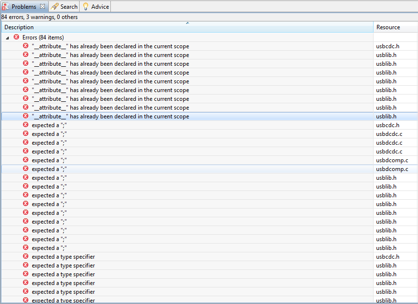

Compiler/OMAP-L138: error while adding usb files to bootloader
Part Number: OMAP-L138
i have a usb code which works fine in arm, now i want to integrate it in bootloader , unfortunately when i copied the library and some other header files related to usb to bootloader project it is showing lots of error. any help would be appriciated
Antony

  • Anthony,
    You seem to either be developing your own code or using USBLIB from starterware for your development. Can you confirm.
    • If this you are not using starterware, please indicate which software package are you using ?
    • What boot mode are you trying to boot from?
    • Please describe in detail what procedure you used to try to boot load your application.
    If you are using Starterware, I recommend that you look at the flashing and bootloading procedure to load and run your application as described here:
    Rahul
  • Hi rahul
    Actually the problem was in the build settings, the language option was not selected, i changed it to "Relaxed parsing (non-strict ANSI) (--relaxed_ansi, -pr) ". finally all the errors flew away :)
    Thanks for your time and effort...
