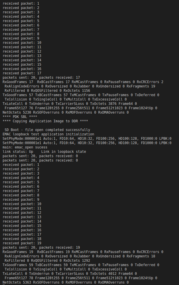

  • Pavel,
    Is your project (board int, phy/emac config) based on "EMAC_BasicExample_idkAM572x_m4BiosExampleProject" from PDK? Are you working on AM572x EVM or IDK? Do you see the issue with both port 0 and port1?
    Garrett
  • Garrett Ding ,
    Our project(board int, phy/emac config) is based on "NIMU_BasicExample_idkAM572x_m4Exampleproject"from pdk_am57xx_1_0_6 . We are working on AM572x IDK. We see the problem only on port1 because port0 does not detect a connection.
    We create project based on "EMAC_BasicExample_idkAM572x_m4BiosExampleProject" project. In the loopback mode, when sending 20 packets, we also get 1-4 responses only
    Alex
  • Alex,
    Are you running the project on AM572x IDK or your custom board? Does the default loopback example pass on your board?
    When your project fails, any error stats in CPSW STATS register?
    Does the wireshare capture show 5 packets or CPSW_STATS GOOD_TX_FRAMES?
    Do you see the same issue if sending packets from ARM core?
    Garrett
  • Garrett,
    We are using the project on AM5728 IDK board. Default loopback example not pass on board. In the example, the package is sent and programm is a wait for the response but the package does not received. We corrected an example that it would not hang forever waiting and it to continue sending 20 packets. Packet size is TEST_PKT_SIZE = 64 bytes.Below is the statistics  from emac_get_statistics
    Packet is sending from arm M4 IPU0-0.

    Alex,
    Can you try the PDK 1.0.9 from PRSDK 4.2 ( )
    Attached log is captured with EMAC_BasicExample_idkAM572x_m4BiosExampleProject which shows 100 packets received properly.
