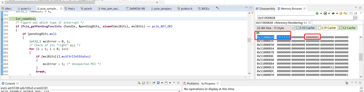

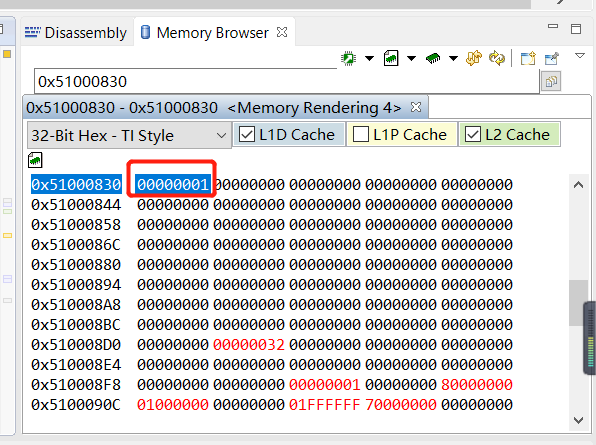

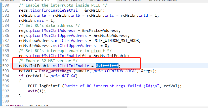

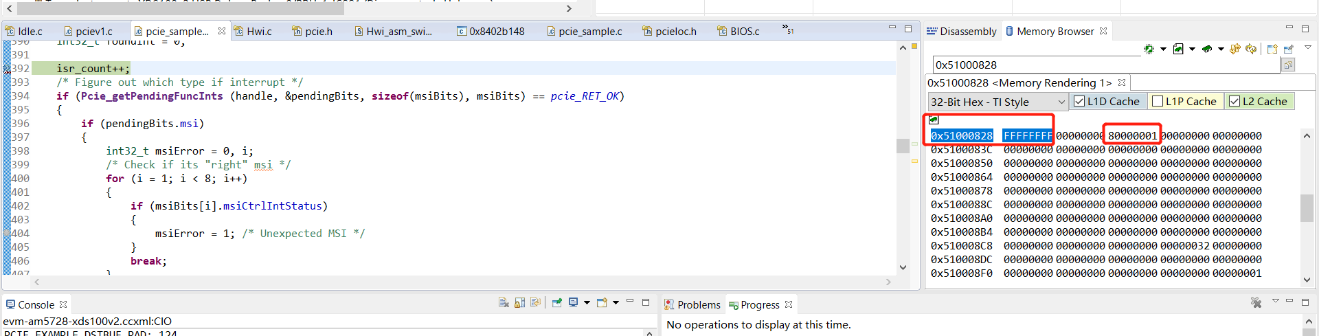

TI, I am using the PCIE_idkAM572x_wSoCFile_C66BiosExampleProject demo,Now I can get the msi from FPGA.

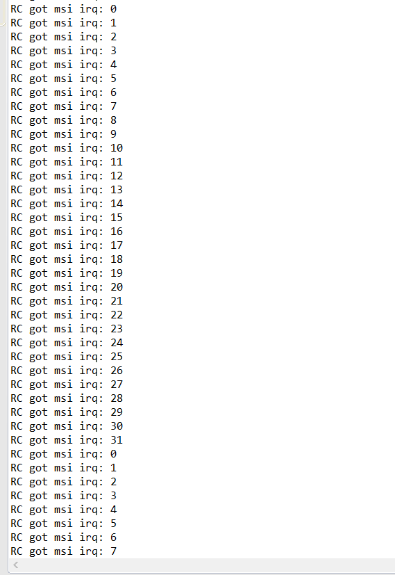

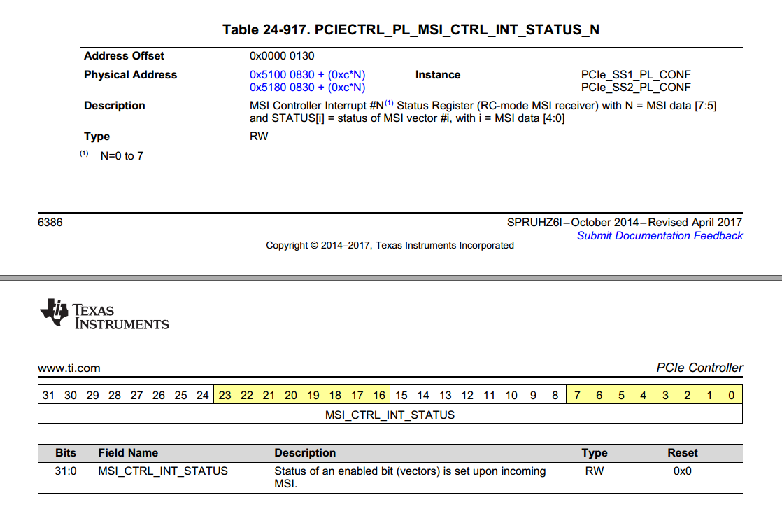

The FPGA send the MSI vector from 0 to 31 to the AM5728, and I want to distinguish which the MSI vector that the DSP got.I look into am5728 Technical Reference Manual  < 24.9 PCIe Controller>,but I not find the register  that I want.
Any suggestion? How can I distinguish the MSI vector from FPGA?
