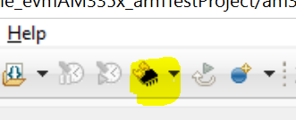

HI TI,
I am working on am335x starter kit with IAR workbench 7.10 in Windows 7. Starting from importing TI examples from c:/ti/StarterWare/build/armv7a/ewarm/am335x/evmskAM335x/
Although IAR build/run the program successfully, it cannot reset am335x starter kit. For example, after download  / run / stop "gpio_card_detect", I have to push the reset button on am335x starter kit, then download / run / debug next example project.
Notice in CCS 7, each example project debug starts as follows, which I did not catch from IAR workbench.
CortxA8: Output: ****  AM3358_SK Initialization is in progress ..........
CortxA8: Output: ****  AM335x ALL PLL Config for OPP == OPP100 is in progress .........
CortxA8: Output: Input Clock Read from SYSBOOT[15:14]:  24MHz
CortxA8: Output: ****  Going to Bypass...
CortxA8: Output: ****  Bypassed, changing values...
CortxA8: Output: ****  Locking ARM PLL
CortxA8: Output: ****  Core Bypassed
CortxA8: Output: ****  Now locking Core...
CortxA8: Output: ****  Core locked
CortxA8: Output: ****  DDR DPLL Bypassed
CortxA8: Output: ****  DDR DPLL Locked
CortxA8: Output: ****  PER DPLL Bypassed
CortxA8: Output: ****  PER DPLL Locked
CortxA8: Output: ****  DISP PLL Config is in progress ..........
CortxA8: Output: ****  DISP PLL Config is DONE ..........
CortxA8: Output: ****  AM335x ALL ADPLL Config for OPP == OPP100 is Done .........
CortxA8: Output: ****  AM335x DDR3 EMIF and PHY configuration is in progress...
CortxA8: Output: EMIF PRCM is in progress .......
CortxA8: Output: EMIF PRCM Done
CortxA8: Output: DDR PHY Configuration in progress
CortxA8: Output: Waiting for VTP Ready .......
CortxA8: Output: VTP is Ready!
CortxA8: Output: DDR PHY CMD0 Register configuration is in progress .......
CortxA8: Output: DDR PHY CMD1 Register configuration is in progress .......
CortxA8: Output: DDR PHY CMD2 Register configuration is in progress .......
CortxA8: Output: DDR PHY DATA0 Register configuration is in progress .......
CortxA8: Output: DDR PHY DATA1 Register configuration is in progress .......
CortxA8: Output: Setting IO control registers.......
CortxA8: Output: EMIF Timing register configuration is in progress .......
CortxA8: Output: EMIF Timing register configuration is done .......
CortxA8: Output: PHY is READY!!
CortxA8: Output: DDR PHY Configuration done
CortxA8: Output: ****  AM3358_SK Initialization is Done ******************
Please advise, thanks in advance
