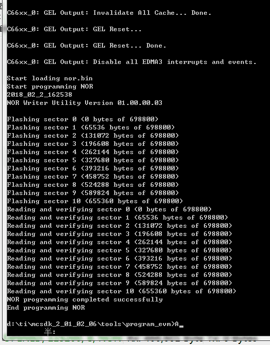

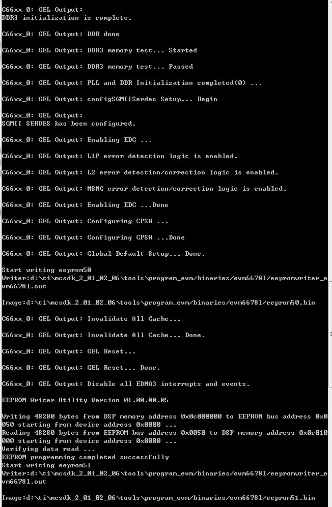

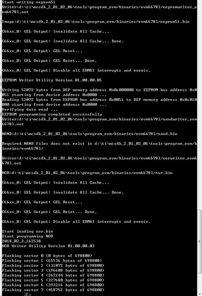

one day, i started to load my .bin file to 6678 throgh net(before that day,using TFTP BOOT to load my .bin file was ok),for some reason i don't know,it can't be loaded.And i restart the power ,i find that the UART have no printf information,usually,it will have the information below:
IBL version: 1.0.0.16
IBL: PLL and DDR Initialization Complete
IBL Result code 00
IBL: Booting from ethernet
so i suspect that my IBL has some problem.after that,i find "get the EVM back to factory default state"in BIOS MCSDK user guide page 117,and i follow the procedure and finally get the output information which indicated that i was done successfully(i think it is)

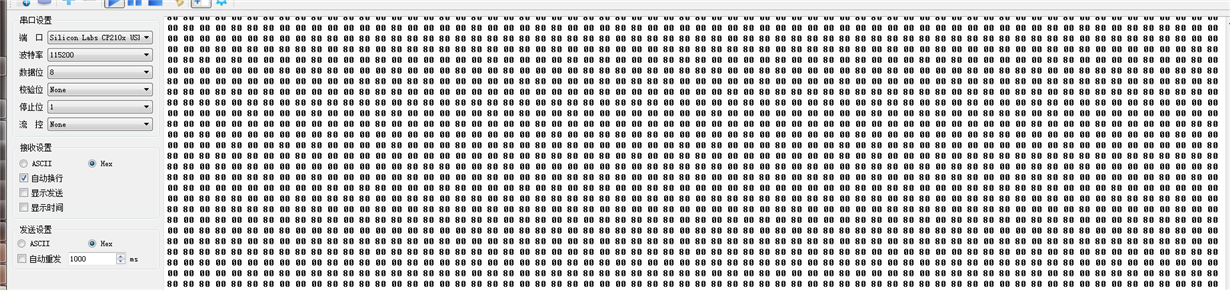

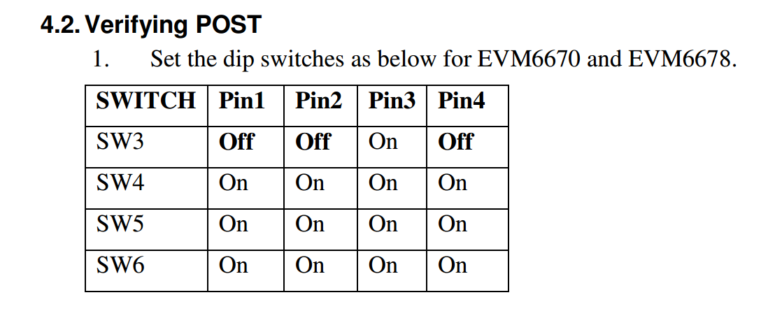

but when i do the Varification as shown in page 14 of program_evm_userguide,the UART didn't print the information described in the doc,but it print some garbled characters like this:
i didn't know what's going on,and when i do the Verifying NOR it also didn't print information like the doc mentioned.briefly,it seems like the IBL can't start up rightly.i hpoe someone can help me,thanks,sincerely!

  • Can you please indicate what doc you are following to complete this operation? Are you certain that you are connecting Serial connection at 115.2 Kbps ? I don`t see any error when you are restoring the IBL and the NOR images. Can you also indicate the boot Switch settings that you used when you restarted the EVM after programming the EEPROM?
  • thanks for your reply.I do the operation following "d:\ti\mcsdk_2_01_02_06\tools\program_evm\program_evm_userguide.pdf",yes,i connect serial port at 115200,the boot Switch settings is set as the doc described,when i verify POST ,i Set the dip switches as the following
    and do the next operations following this
    but the print information is not right,so i don't know the IBL is start up rightly or not

    Thanks.
  • Another thing I forgot to say,after I power on ,the 4 LEDs are on,in MCSDK user guide,it says
    "At power on, the DSP starts execution with bootrom which transfers execution to the POST boot program from
    EEPROM using the I2C slave bus address as 0x50. The POST will then run through a sequence of platform tests.
    Upon power on, all the 4 FPGA debug LEDs will be on by default, remain ON for approximately 10 sec, then turn
    OFF if all the tests complete successfully. If any of the tests fails, the LED(s) will blink"
    but my 4 led always on even if after 10 sec,does this mean that the POST failed?
