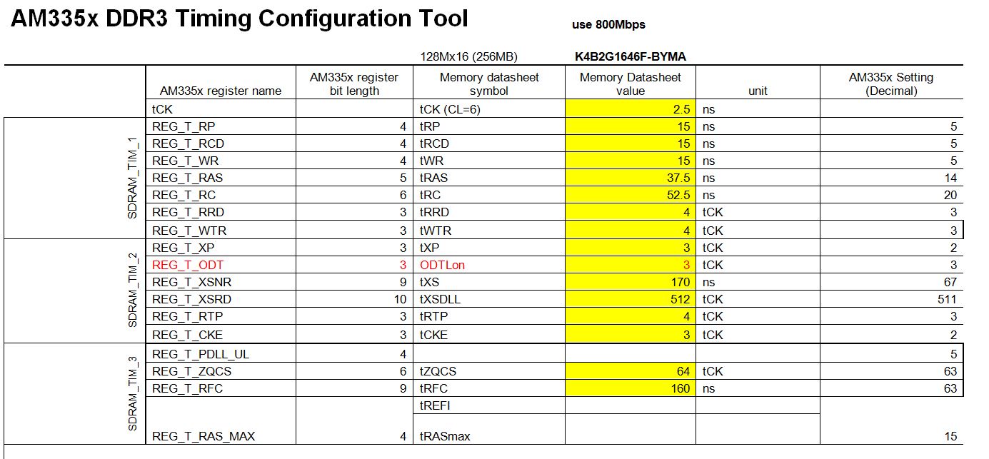

  2. The AM335x DDR Register Calc spreadsheet requires an  ODT low on parameter (REG_T_ODT).  This is not listed on Samsung data sheet.  Parameter in highlighted in RED below.  How can I get this parameter?  Can this be calculated indirectly from other listed parameters on the Samsung data sheet?
    ODTLon is a JEDEC parameter and should be part of the DRAM data sheet. I'm unsure why the specific DRAM part does not list this. You may want to check with the DRAM manufacturer regarding the same. Per JEDEC spec, this should be [CWL + AL - 2] tck. For instance, if CWL = 5tCK, AL = 0; ODTL should be set as 3tCK
    Let me know if you have any additional questions.
