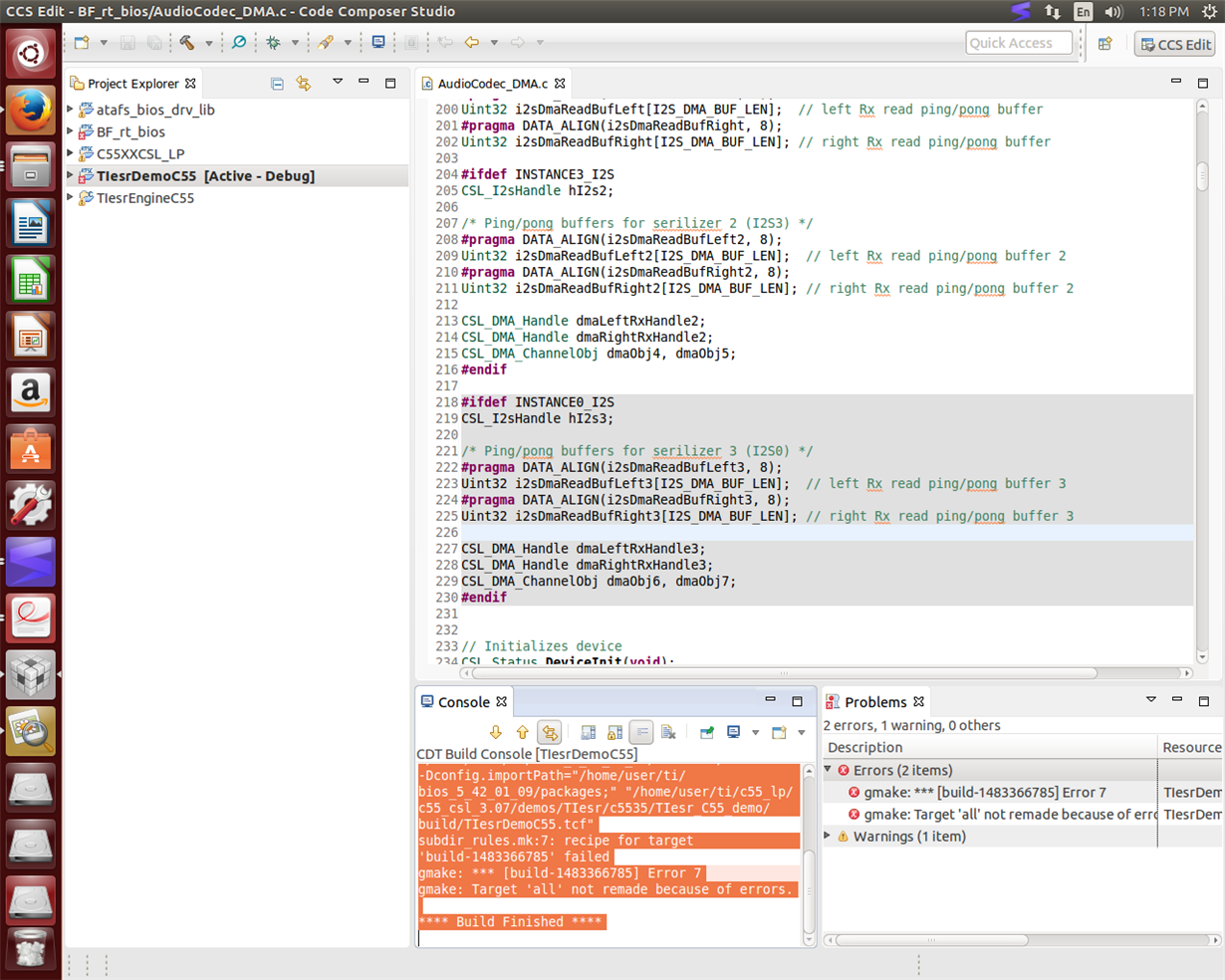

i am working on ccs 6.0.2 version for the past few days presently i am working on speech recogniser kit but i am getting many error as
"/home/user/ti/bios_5_42_01_09/xdctools/tconf" -b -Dconfig.importPath="/home/user/ti/bios_5_42_01_09/packages;" "../BF_rt_bios_cfg.tcf"
subdir_rules.mk:14: recipe for target 'build-245787055' failed
gmake: *** [build-245787055] Error 7
gmake: Target 'all' not remade because of errors.
**** Build Finished ****
i an not be able to find errors can anyone give ideas to reduce errors

  • i am working on speech reconize_system for the past three days.when i am building TlesrDemoC55 and BF_rt_bios i am getting error as below
    for TIesrDemoC55
    **** Build of configuration Debug for project TIesrDemoC55 ****
    /home/user/ccsv6/utils/bin/gmake -k all
    Building file: /home/user/ti/c55_lp/c55_csl_3.07/demos/TIesr/c5535/TIesr_C55_demo/build/TIesrDemoC55.tcf
    Invoking: TConf
    "/home/user/ti/bios_5_42_01_09/xdctools/tconf" -b -Dconfig.importPath="/home/user/ti/bios_5_42_01_09/packages;" "/home/user/ti/c55_lp/c55_csl_3.07/demos/TIesr/c5535/TIesr_C55_demo/build/TIesrDemoC55.tcf"
    subdir_rules.mk:7: recipe for target 'build-1483366785' failed
    gmake: *** [build-1483366785] Error 7
    *** Build of configuration Debug for project BF_rt_bios ****
    Building file: ../BF_rt_bios_cfg.tcf
    Invoking: TConf
    this is the error where i am getting AartiG

  • ktr,
    Do you have DSP BIOS 5_42_00_07 as mentioned in the instructions www.ti.com/.../tidubj5a.pdf installed?
    software-dl.ti.com/.../index_FDS.html
    Lali
  • Lali'
    Thank you Lali. It is working
    ktr
