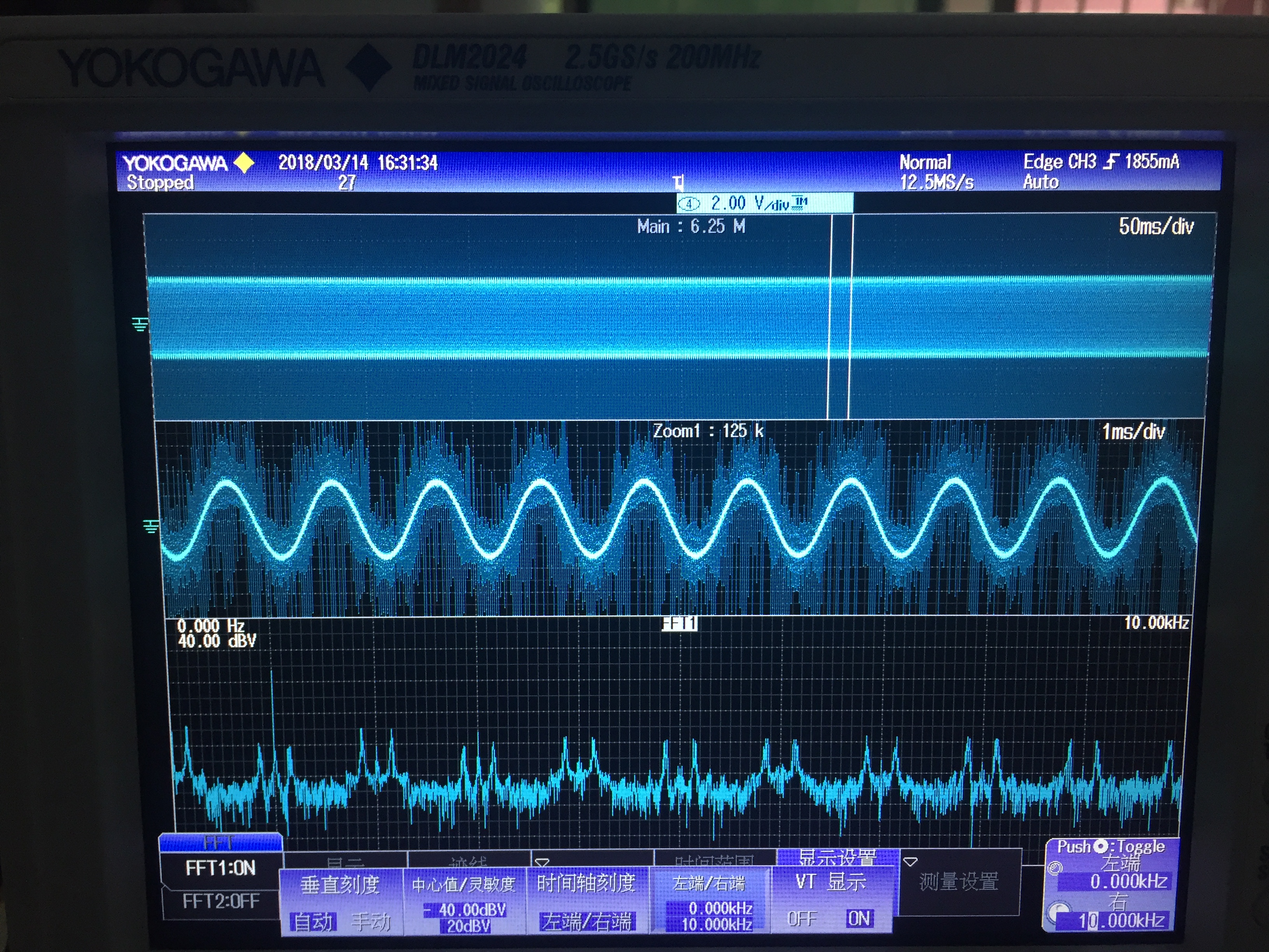

I met a problem that the chip TMS320C6748 setting pwm module with clock 456Mhz, 50Khz and triangular wave. After use FFT to analyze the modulate wave from the IOs, i found the low frequency harmonic wave come from switching signals. I changed better input power but no improved and then i changed the switching frequency, the harmonic wave changed also. have you meet this before? what can i do to improve this?

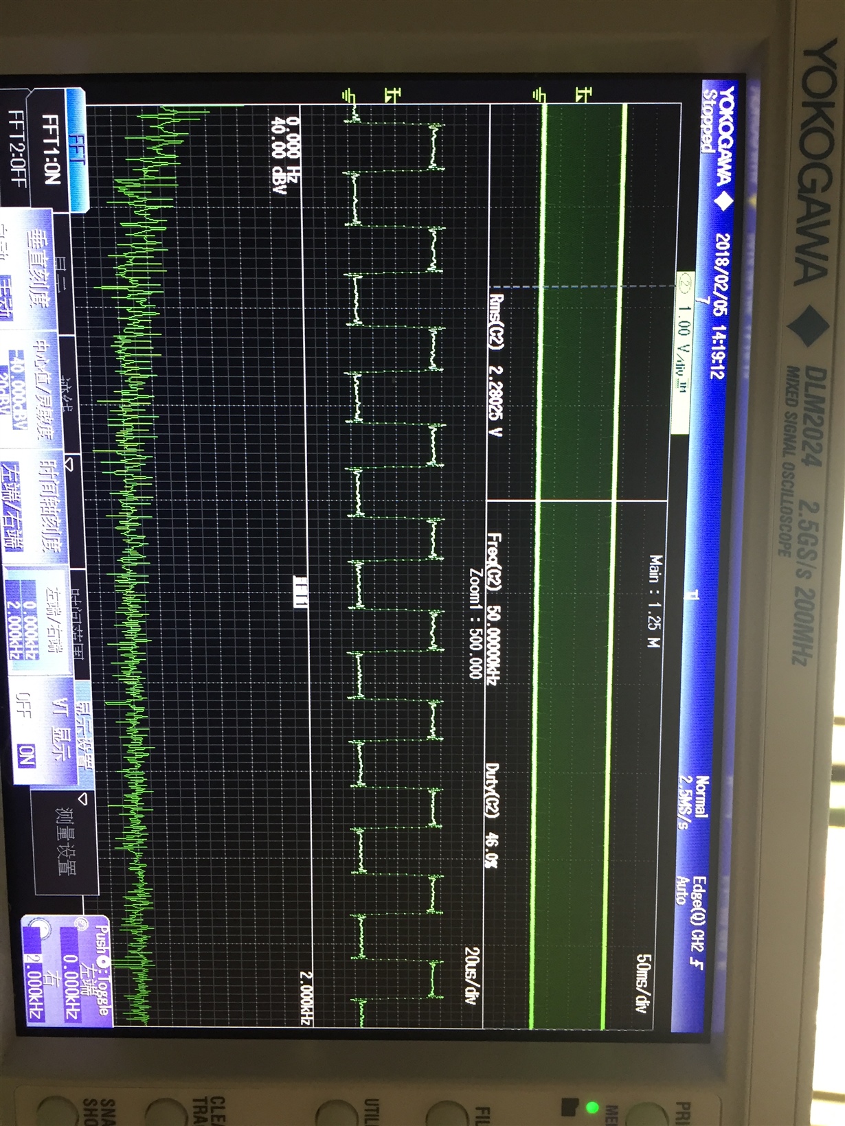

     The scope i captured when the PWM is working.
    the first and second screen is the PWM output signal, amplifier singal, the third screen is for the PWM singal's FFT analyse. you can see low frequency parasitic harmonic about 74hz. the frequency is increased by linear from left to right.
    When i changed the PWM frequecy, the parasitic harmonic changed also. It seens come from the inner of DSP. The parasitic singal ruins output voltage quality of my system.
    The tested board is from your corporation partner GUANGZOU CHUANGLONG. May be the layout or some else cause the phenomenon.  I tried to solve it and bought the OMAP-L138/C6748 LC Dev Kit from agent of TI.
    The THD harmonic hasn't sloved also, but the harmonic frequency changed.  I compared these two boards and found the crystal oscillator is different. I don't know if the phase noise or clock jitter lead to different.
    I am trying to buy different types oscillators for test.
     if your can give us more perfessional ideals about this, it's great help for us.
    the latest picture captured test the PWM IO signal and the board is designed by TI.
     the third screen analyse the PWM signal's FFT, the frequency is from 0Hz to1kHz.

    I can show your latest test result by CHUANGLONG's board, the below picture i captured is the load voltage. you can see the FFT ananlyse, the even-order harmonic shouldn't comes out from the ground noise and the odd harmonic shouldn't aliasing so big low frequency modulation signal. .
    I don't know if you have meet the same phenomenon before. Do you have the related data sheet for clock jitter or phase noise about the DSP?
    Best wishes,
    Howard

    4. The sine wave i posted was capture from the load of our system(H bridge, after low pass filter), your can see clear harmonic wave. the other picture is the signal come from DSP PWM IO, the two signals are before or after low pass filter. you can see the low pass filter lead to the green signal delay a little and the PWM signal changed, but the harmoinc is better than the signal without low pass filter.
