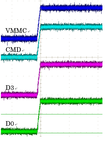

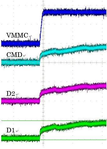

In the normal boards, CMD and D0-D3 line's rise time and the voltages are stable
but in bad board the CMD line voltage fluctuates from 2.7V to 3.3V and the rise time
of these lines is bit slow compared to the normal boards.
Normal Board:
Bad Board:
VMMC = VDD, D0-D1 lines are also same.
It seems the CMD and data lines are being pulled(around 12Kohm to 15Kohm) by AM335x.

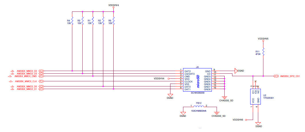

The SD card circuit connection is same as the StarterKit schematics with additional
GPIO connection for WP(Write Protect). CMD and Data lines are pulled up with 10K resistors.
