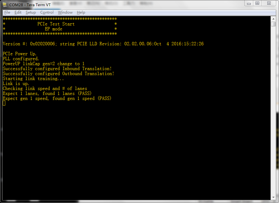

But when we put the am5728-evm(EP) to PC PCIe slot,and run the program.the program is always at "Starting link training..".
I have doubts about the 100Mhz hardware design,but at sometime,the link is up.....but PC do not detect the EP board.

    If sometimes you saw the linkup from the AM572x EP side, can you check the register 0x51002104 bit 2:7 for LTSSM state, is it 0x11 for L0 status and keep there? If not, then it came to L0 state then dropped so your host PC can't detect it.

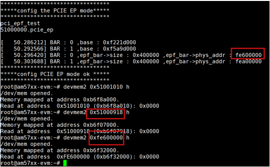

    at pci_epf_test_set_bar() function. epf_bar->phys_addr this address will used to set the inbound function.
    I can use devmem2 tools to check the data.
    You can try this address.

        But I can not read data from the address epf_bar->phys_addr at pci_epf_test_set_bar() function, and I can not read data from the 0x51000918 address too.
        Thank you all the same. I will try in other way.
    from your picture log.I do not think your PC driver is right at here.
    If the PC driver is right,and the 0x51001010 is not 0x0,it will be the PC PCI address.
    Secondly,I can read the data at the epf_bar->phys_addr,is allocated by pci_epf_alloc_space() function.or you can specify a fixed address to the epf_bar->phys_addr variable in kernel.
    Also,you can use devmem2 tools or windriver to set the address map.It will let the BAR1 to 0x80000000 DDR address.but you must set the BAR0 map to 0x51000000 first.
