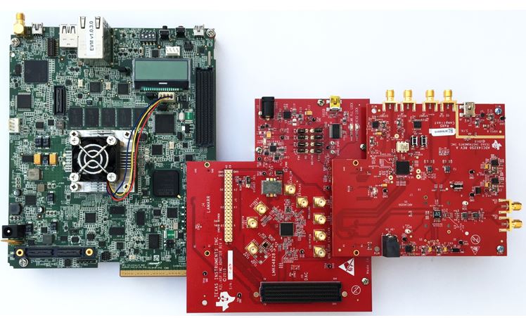

  • Hello ,
    We have 3 boards , 66AK2L06 EVM ver. 1.0.3.0 , ADC14X250EVM rev B  and DLC board that we produced according the desing files.
    We have no DAC Board, because  we want to use only ADC Board and see any Signal generated by us in RX side RFSDK Demo software.
    Can we do it without a DAC Board ?
    I did everything with the order except DAC according to the document , but I am getting this error below when I write radio init.
    How to fix this problem , Could there be a problem due to not having a DAC Board ?

  • Hello Anil,
    We have only done the test as described including the DAC board.  I suggest you either order the DAC38J84 EVM for the actual test described, or contact your Local TI Field Application Engineer to see if he has a DAC board you could borrow for a test.
    a) when you first run the RFSDK
         please make sure you select the Appropriate Design #2 adjacent market configuration from the GUI, this configures the RFSDK to know the
         data converters are programmed differently than the Small Cell AFE7500 device (native to RFSDK).
    b) you will need to have the GUI for the Clock DLC, ADC, and DAC an their programming complete, before the RF Init process.
    I will ask the developer if there is an option to have no DAC installed, however we have customers that run the demo with the ADC, DLC, and DAC EVMs attached.

    The developer test uses the DAC EVM, with the ADC EVM. I would try your test with the DAC EVM. The test procedure loops back the DAC output to the ADC.
    Joe Quintal

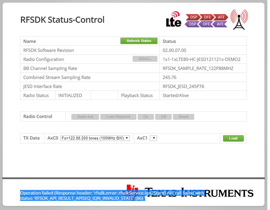

  • Hello Joe ,
    We have done all steps in tidub94a document , except below steps;
     * Update the UBIFS Image on the 66AK2L06EVM
        We skipped this step because we were worried about the error on the link. So we decide to use on board mcsdk version. ( actually we dont know version but we use it )
         https://e2e.ti.com/support/dsp/c6000_multi-core_dsps/f/639/t/615477?tisearch=e2e-sitesearch&keymatch=rfsdk%20api%20error
         When we run this board configuration. We get radio init error ( as we said above first ). So we tried to "lamarr-evm-demo2-mcsdk3125" version. then radio init runs with no problem.
    But in now we get the following error when we try radio on over demo gui.
    Operation failed (Response header: 'rfsdk.error: rfsdkService.Iqn2Start() API call failed with status 'RFSDK_API_RESULT_APISEQ_IQN_INVALID_STATE' (86) '
    So how we get over this problem. Actually we want to read data from JESD / ADC.
    In earlier versions of MCSDK and RFSDK, there was a added package for Demo2. The later RFSDK version needs the mcSDK 3147
    this has to do with the peripheral software. The IQN2 software in MCSDK3125 does not seem to be compatible with RFSDK 207
    a) update the board mcSDK version to 3147. following the RFSDK installation guide
    b) or using the demo2 Getting Started Guide, and User Guide, downgrade the mcSDK and RFSDK to the version in this guide, request the demo2 extra files, and configure for use.
