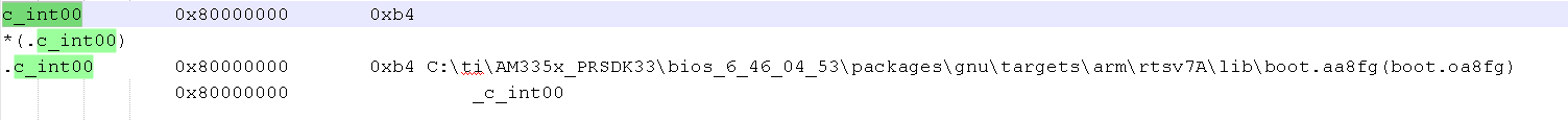

    Okay, step ONE.  A brutally simply "Flash the LED" program works when written in GNU, but doesn't work when written in TI compiler. Identical code.
    The GNU version has a map file that says:
     .c_int00       0x80000000       0xb4 C:\ti\bios_6_46_05_55\packages\gnu\targets\arm\rtsv7A\lib\boot.aa8fg(boot.oa8fg)
                    0x80000000                _c_int00
    So, we can see that the entry point is at the beginning of the memory location, where we would expect.  On the other hand, the TI version map files says:
    OUTPUT FILE NAME:   <TI_BLinkTest.out>
    ENTRY POINT SYMBOL: "_c_int00"  address: 80008698
    So, we can see it does't match.  And I know of no way to FORCE it to match.  The Sys/Bios is providing this stuff...

    Here's the code from the MLO  sbl_mmcsd.c, line 221:
            pDestAddr = (uint8_t *)imageHdr.load_addr;
            *pEntryPoint = imageHdr.load_addr;
    So, how am I supposed to set an entry point for the "_c_int00" location that is DIFFERENT from the destination address?  Because that is what the TI version of the tools did to me!
    Or... how am I supposed to tell the TI version of the compiler tools to place the "_c_int00" function (or it's equivalent BL instruction) at the location 0x80000000 to match the load address??  I'll be happy to just add a miniature assembler code with a BL instruction, if I could tell the build system where to place it.  But alas, the Sys/Bios doesn't let me do that that I can find.
  • Chris,
    For this mechanism to work, your load address and entry point needs to align. My recommendation is still to use the guidance provided in the wiki but modify this to match your linker output

     I added ".c_int00 { boot.aea8f<boot.oea8f>(.text) } : load > 0x80000000, run > 0x80000000" to the script.  And of course the XDC barfed all over it.
    js: "C:/Users/scott/workspace_v7/TI_BLinkTest/app.cfg", line 1: Compilation produced 1 syntax errors.
    js: "./package/cfg/app_pea8fnv.cfg", line 195: Compilation produced 1 syntax errors. (C:/Users/scott/workspace_v7/TI_BLinkTest/app.cfg#1)
    gmake.exe: *** [package/cfg/app_pea8fnv.xdl] Error 1
    So my question remains:  How do I coerce the build environment to set these values to what I want, when it doing all this stuff behind my back, and under the covers?
    I know WHERE the load and entry point needs to be.  I know WHAT ADDRESS the entry point needs to be. I know WHAT SYMBOL needs to be set to that address.  I know what SECTION NAME needs to be set to that address...  How do I do it when XDC and Sys/BIOS are running everything behind my back and don't let me control it?

    Can you spell this out??  All I am doing it throwing random changes because nothing is specific.
    In my "custom.cmd" file:
    Error:
    <Linking>
    "../custom.cmd", line 1: error #10008-D: cannot find file ".c_int00"
    "../custom.cmd", line 1: error #10021-D: expecting filename, option, MEMORY, or SECTIONS instead of "{"
    "../custom.cmd", line 1: error #10021-D: expecting filename, option, MEMORY, or SECTIONS instead of ":"
    error #10010: errors encountered during linking; "TI_BLinkTest.out" not built
    Then I changed the label:
    ._c_int00 { boot.aea8f<boot.oea8f>(.text) } : load > 0x80000000, run > 0x80000000
    Error:
    <Linking>
    "../custom.cmd", line 1: error #10008-D: cannot find file "._c_int00"
    And again, change the label:
    Still:
    <Linking>
    "../custom.cmd", line 1: error #10008-D: cannot find file "_c_int00"
    Okay... enough of this...  lets try making a "linker" looking script:
     SECTIONS {
       .text:c_int00 > 0x80000000
    No error, but the entry point is still 0x80008698.  Tried "._c_int00"  "_c_int00"  etc...
    Try sticking that text from the E2E posing inside a "section"
     SECTIONS {
       .text:.c_int00 { boot.aea8f<boot.oea8f>(.text) } : load > 0x80000000, run > 0x80000000
    Nope. Error:
    <Linking>
    "../custom.cmd", line 2: error #10008-D: cannot find file "boot.aea8f"
    "../custom.cmd", line 2: error #10026-D: expecting output section, GROUP, or UNION instead of ":"
    "../custom.cmd", line 2: warning #10068-D: no matching section
    ( boot.aea8f is the startup entry generated by XDC??  But not in this case.  So what is it in this case?  And where is that documented?)
    So I tried removing that file, and using "_c_int00"  "._c_int00"  ".c_int00"  ".c_int00"...
    SECTIONS {
       .text:c_int00  : load > 0x80000000, run > 0x80000000
    No build errors, but the entry point in the map file is STILL
    It is not working.
  • It works now...
    I have a "custom.cmd" file in the root level of the project.  After carpet bombing a bunch of different things, I dug into the MAP file to find out where this mystery SYSBIOS library was providing the
    "_c_int00".  Based on the address of 80008698, I looked at the map file, and it turns out is it something called boot.aea8fnv...  and, if I am reading the map file correctly, that was pulled from object file boot.oea8fnv.
          800085a0    0000007c     sysbios.aea8fnv : arm_TaskSupport_asm.obj (.text:_ti_sysbios_family_arm_TaskSupport_buildTaskStack)
          8000861c    0000007c     ti.targets.arm.rtsarm.aea8fnv : Assert.oea8fnv (.text:xdc_runtime_Assert_raise__I)
    --->> 80008698    00000074     boot.aea8fnv : boot.oea8fnv (.text)
          8000870c    00000074     sysbios.aea8fnv : BIOS.obj (.text:ti_sysbios_family_arm_a8_intcps_Hwi_dispatchFIQC__I)
    So, next I had to create the "SECTION" in my custom.cmd file to tell it to load that at address 80000000:
    SECTIONS {
        .text:_c_int00 { boot.aea8fnv<boot.oea8fnv>(.text) } > 0x80000000
    But this one failed as "file not found".  (Why??  The linker knows where that file is when it linked...?).  So I seached the bios_xx_yy_yy_aa folder for that file, and found it. Then I put the absolute path into the script:
    SECTIONS {
        .text:_c_int00 { C:\ti\bios_6_46_05_55\packages\ti\targets\arm\rtsarm\lib\boot.aea8fnv<boot.oea8fnv>(.text) } > 0x80000000
    Re-ran the build, and got the entry point where it's supposed to be.
    ENTRY POINT SYMBOL: "_c_int00"  address: 80000000
    output                                  attributes/
    section   page    origin      length       input sections
    .text:_c_int00
    *          0    80000000    0000008c
                    80000000    00000074     boot.aea8fnv : boot.oea8fnv (.text)
                    80000074    00000008     rtsv7A8_A_le_n_v3_eabi.lib : args_main.obj (.tramp._args_main.1)
    Then I could create the "app" using the "arm-none-eabi-objcopy.exe" and the "tiimage.exe" programs, load it on the SD card, and it worked.  My little batch file to do that is
    C:\ti\ccsv7\tools\compiler\gcc-arm-none-eabi-6-2017-q1-update\bin\arm-none-eabi-objcopy.exe -O binary TI_BLinkTest.out TI_BLinkTest.bin
    C:\ti\pdk_am335x_1_0_7\packages\ti\starterware\tools\ti_image\tiimage.exe 0x80000000 NONE TI_BLinkTest.bin app
    Where (in this case) the compiler output file name was "TI_BlinkTest.out" and it generates the file named "app".
