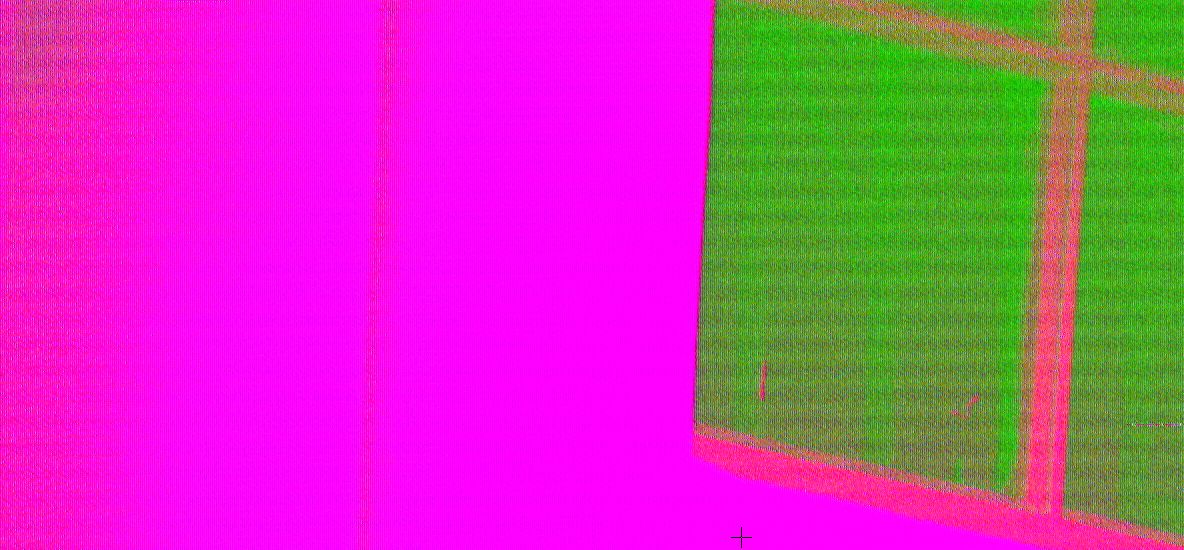

Hi All,
    I have a 6437 based customized board capturing raw image from CCD imaging sensor. I am trying to convert the raw bayer image into YUV4:2:2 by feeding it to previewer engine .
    More info on the previewer configuration I use:

4)The result of the previwer as follow:
Obviously, the picture oniy has R and G, no B.
I don't konw why the white turn to red pass the previwer?
When i set the SLV  and EPH ,Image color does not change.
Can anyone help me?
  • Hi!
    I have a configuration like this here:
    prevParams.outPixelOrderParam = PSP_PREVIEWER_PIXELORDER_YCBYCR
    And the blending (I dont know why exactly... but....)
    prevParams.rgbBlendingParam.blending[0][0] = 0x100;
    prevParams.rgbBlendingParam.blending[0][1] = 0x00;
    prevParams.rgbBlendingParam.blending[0][2] = 0x00;
    prevParams.rgbBlendingParam.blending[1][0] = 0x00;
    prevParams.rgbBlendingParam.blending[1][1] = 0x100;
    prevParams.rgbBlendingParam.blending[1][2] = 0x00;
    prevParams.rgbBlendingParam.blending[2][0] = 0x00;
    prevParams.rgbBlendingParam.blending[2][1] = 0x00;
    prevParams.rgbBlendingParam.blending[2][2] = 0x100;
    Marcio
