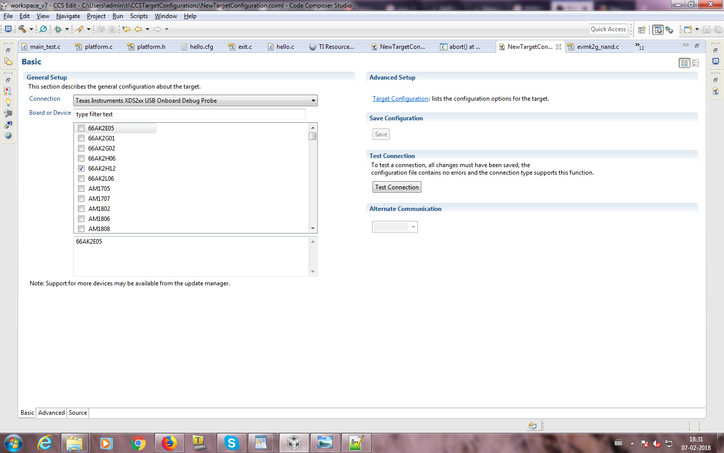

I have configured the target as
and I used C:\ti\ccsv7\ccs_base\emulation\boards\xtcievmk2x\gel file.
But when I run the code I am getting following error

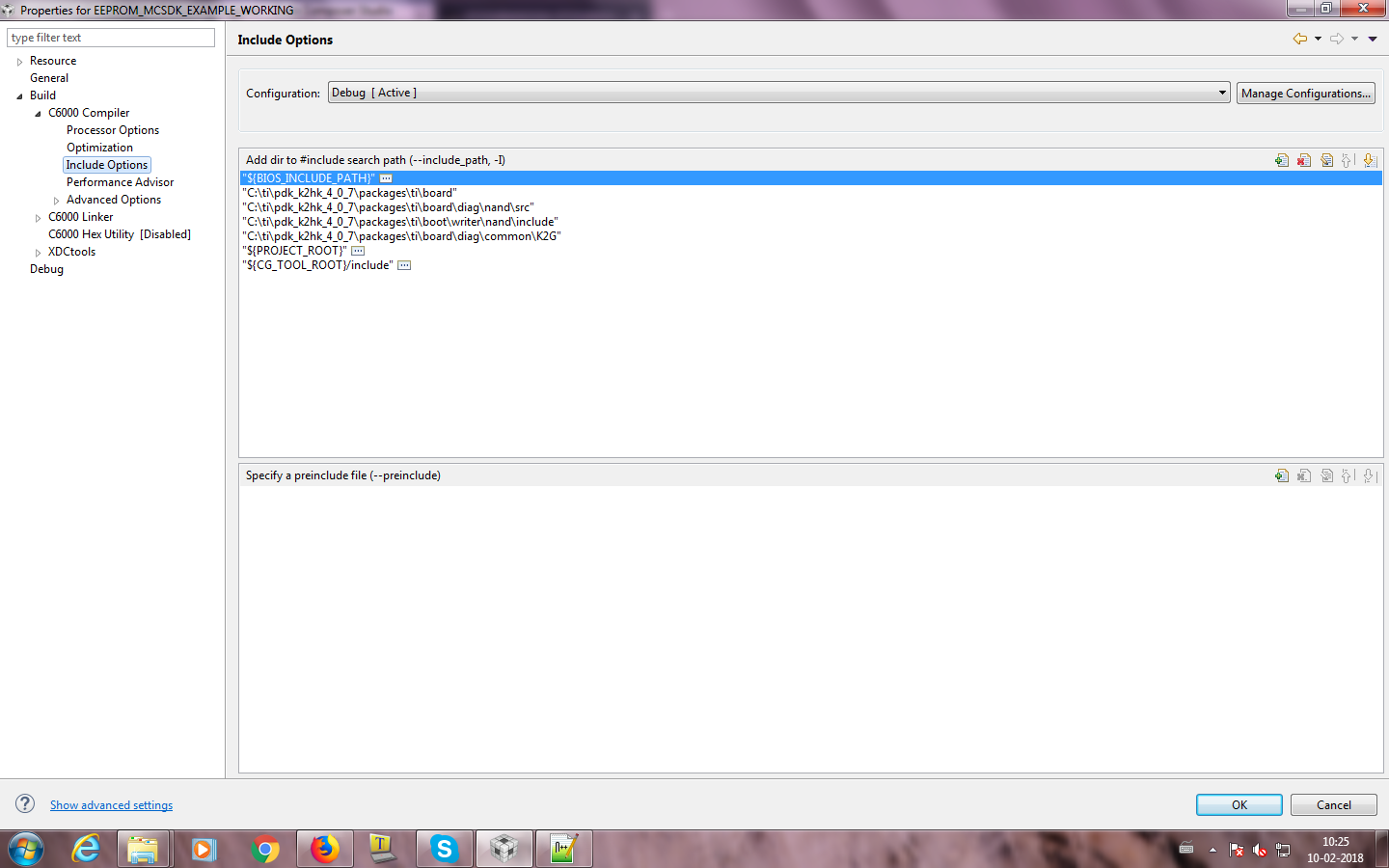

    First I imported hello_66AK2H12_C66XX and then I copied C:\ti\pdk_k2hk_4_0_7\packages\ti\boot\writer\nand\src\nandwriter.c code into hello.c
    then I added the headers in the include options as below,

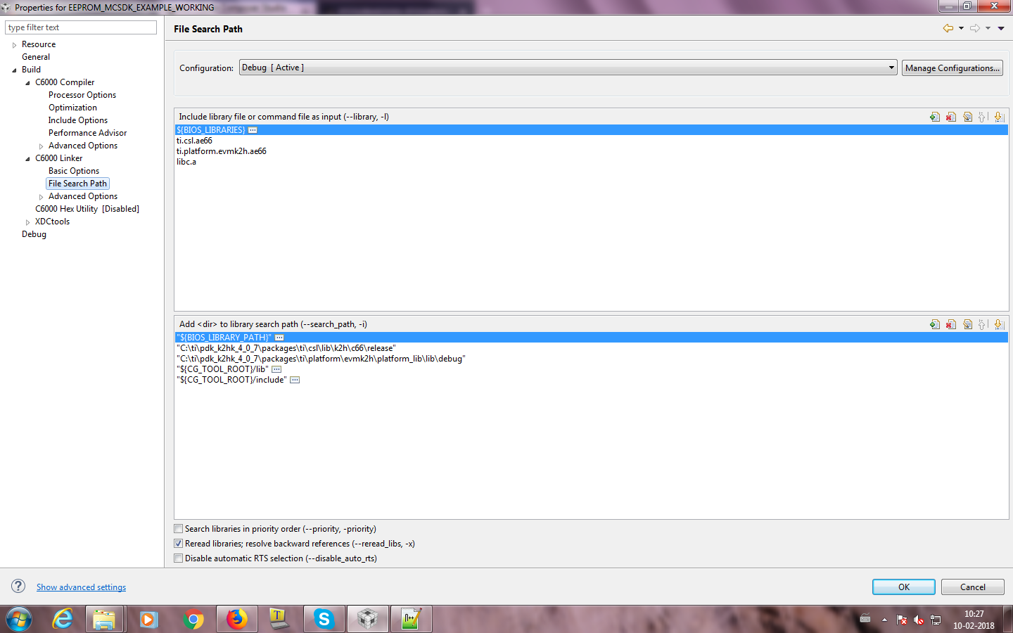

    then I added following libraries
    It was building fine but when I try to run on EVM it was giving
