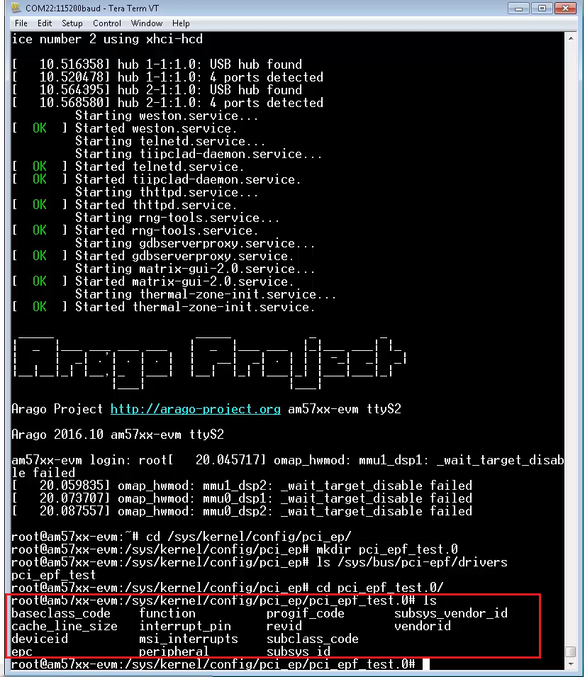

13 plug in the sd card into IDK and boot. (without connecting the cable). nothing shows when I "lspci"
14. plug in the cable on IDK as well as PC motherboard, boot again, problem remains.

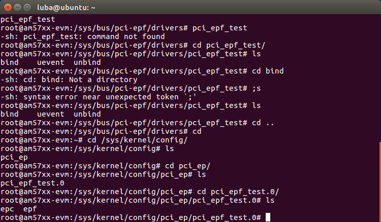

According to the training video from above link, I should see a bunch of stuff under /sys/kernel/config/pci_ep/pci_epf_test.0.  However, I only see epc and epf in there. And there is nothing shows when I "lspci"

  • According to that post, it seems like IDK needed to be modified in order to talk to PC via PCIE, I will wait for our custom board to be ready before going further.
    However, when following the PCIE training video, I only see epc and epf instead of other stuff (in second pic)
    Anyone knows why?

  • Yes, I found the problem because there are two Kernel sections, labeled as 4.4 and 4.9 but does not say which one to follow for am5728.

  • I managed to fix the EP side, but still have issue on RC side.
    On RC side, I am supposed to see a pci driver ("pci_endpoint_test driver creates the Endpoint Test function device (/dev/pci-endpoint-test.0)") under root/dev (not /sys/kernel/config/dev), but its not there. I thought thats because I didn't enable the driver. So, then I tried to enable the Endpoint Test feature for the RC in the kernel, but that requires enabling endpoint mode (this is RC side). Could you show me how that works?
  • Hi, Xiang,
    I checked the .config file in 4.1 release, the configuration has all set up already by default.

    All you need to do is to have 2 different DTS files, one for EP and one for RC. Is it not your case?
    If it still doesn't work for you, then I'll need to bring up my set up. If I can't get it done today, I'll be out of office starting tomorrow and continue after I am back on 2/21.
    Rex
  • IDK-to-IDK connection works now. I will create another post for further support on PC linux-to-IDK connection.
