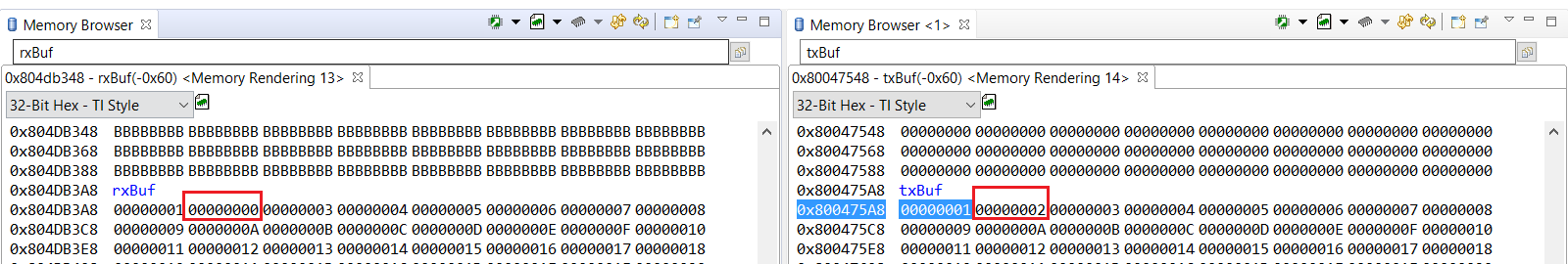

Hello.
I have done some testing on the "QSPI_BasicExample_idkAM571x_armTestProject" example project in PDK108.
When testing the project without changing any code, everything seems to be working fine. however, i have two issues, and need to solve at least one of them.
Issue 1:
I have used the code to copy files to the flash (similar to the flashwriter tool program in pdk/boot) by using memory map mode. However, when using memory map mode in SF25FL_bufferWrite() in S25FL.c, only 1 Byte is transfered per transaction. This is working, but takes too long time. (about 40 seconds for 270 kB).
Is it possible to copy 256 bytes in one transfer (page programming) when using memory map mode?
Issue 2:

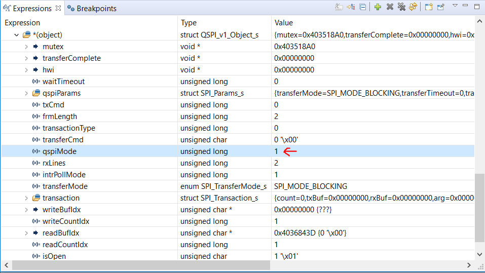

If not possible to solve issue 1, i have an issue with config mode writes. in the same example project, 256 bytes are transferred at once when using config mode writes. however, my issue is that from byte number 257, only 0xFF are read back after writing. for the bytes from 1 to 256, everything seems to be working fine in this mode.
The config mode code is not changed in the project, except changing the number of bytes to transfer. (originally it was 200 bytes).
Thanks for your continuous support.
Anders.

    I am sure that the sectors to be programmed are erased before programming to them. To be sure, I have now implemented the code in SBL_qspiFlashWrite and SBL_qspiFlashRead. Same results.
    To be sure that we are speaking of the same things: a block is 64 kB (and sometimes 4kB). I am now testing with max 1kB data. Therefore, I am always writing to block 0. however, the problems occur when writing to byte number 257. Let us call 256 Bytes a page. writing to the first page works fine, but when writing to the second page, the data read back is not correct (only 0xFF).
    in C:\ti\pdk_am57xx_1_0_8\packages\ti\drv\spi\test\qspi_flash\src\Flash_S25FL\S25FL.c,
    the code for dealing with the page programming can be found:
    if(QSPI_OPER_MODE_CFG == object->qspiMode)
    * Config mode write supports 256 bytes at a time. So if the length is
    * greater than 256, then multiple transactions have to be performed till
    * all the bytes are written.
    while(length > 256)
    SF25FL_ConfigMode_Write(dstOffstAddr, srcAddr, 256, flashHandle);
    dstOffstAddr = dstOffstAddr + (256 / 4);
    srcAddr += 256;
    length -= 256;
    if(length > 0)
    SF25FL_ConfigMode_Write(dstOffstAddr, srcAddr, length, flashHandle);

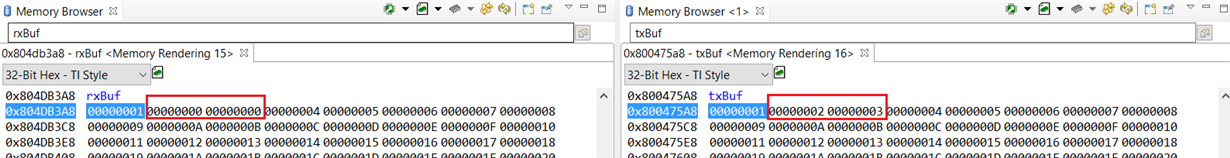

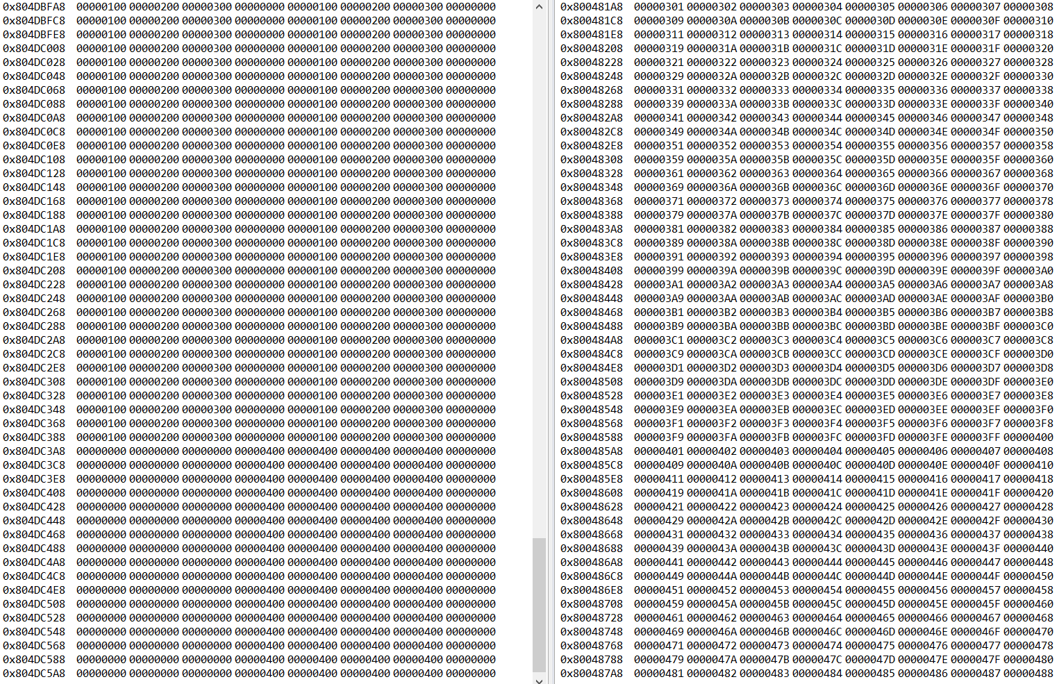

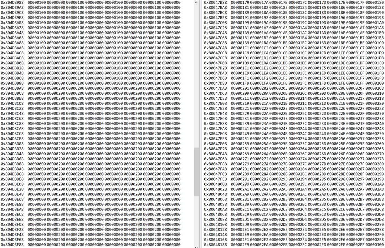

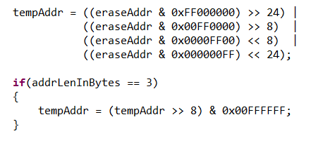

    FYI: I found out that when starting with offset 0x10000U (starting at the second block), i get 1 byte wrong offset when i read back the data. But I am then able to read back 2 pages that do not have only 0xFF.
    I have done some testing and debugging on this, and it seems that the correct data is sent in to the function QSPI_cmd_mode_write_v1() in C:\ti\pdk_am57xx_1_0_8\packages\ti\drv\spi\src\v1\QSPI_v1.c. It also seems that the data is sent to the flash (at least 0xFF is not sent).
    Do you have any suggestions on what to further debug/test?
    Perhaps you could test writing with config mode with more than 256 Bytes on your system?
    Appreciate your help,
    Anders

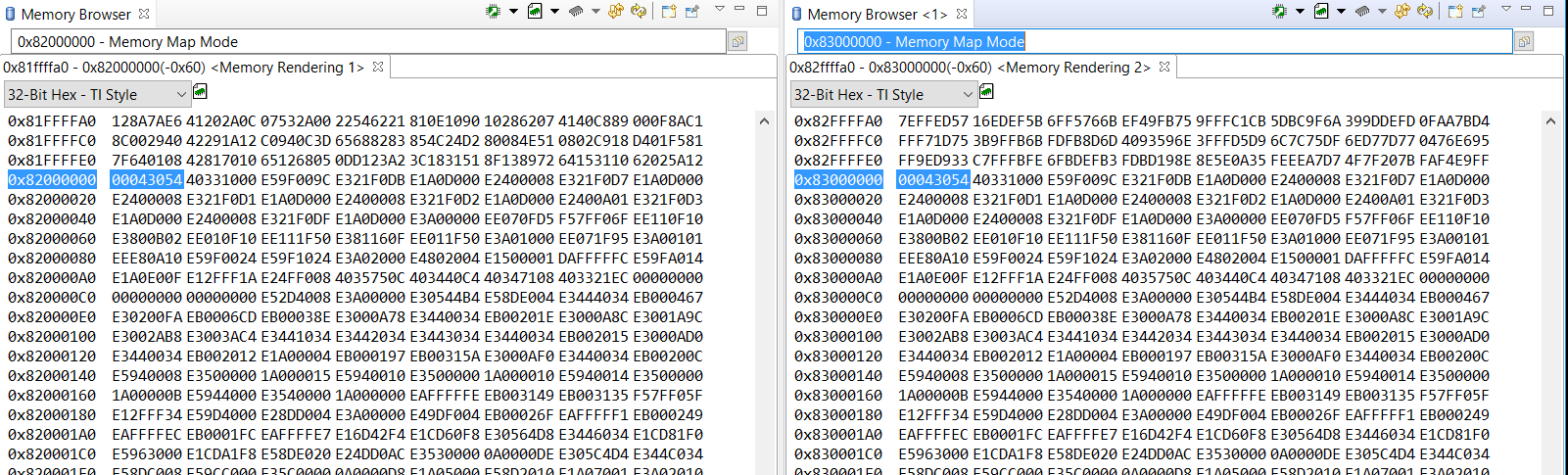

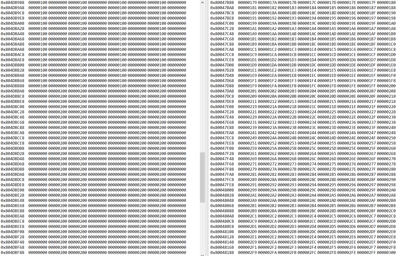

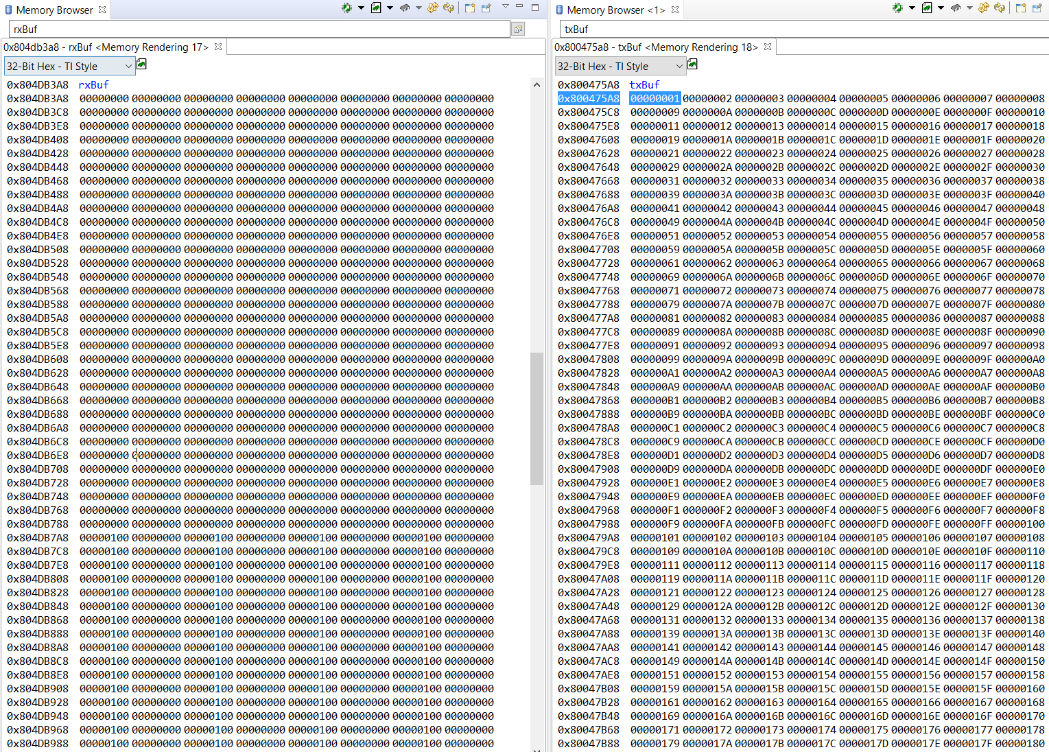

    FYI what I am trying to make is a production flashing tool with SD card files as input. The code is working with MMAP mode and transaction length of 1 Byte. The problem is that it takes to long time to program one byte at each transaction. Maybe the easiest issue here is this issue (issue 1). MMAP is the mode meant to be used for programming the flash with boot and app files (?). However, I found config mode to write quite fast as well (unfortunately with wrong data).
    I have done some more debugging on the mmap mode with transaction length of 256 Bytes (and other length as well, same results). In C:\ti\pdk_am57xx_1_0_8\packages\ti\drv\spi\src\v1\QSPI_v1.c

        // anders debug check data of 256 bytes after pDst. pDst is address on flash. Only first Byte is written, others are read as 0xFF.
        int i;
    uint8_t dataDst[256]; for(i=0;i<256;i++) { dataDst[i]=pDstOrig[i]; } uint8_t dataSrc[256]; for(i=0;i<256;i++) { dataSrc[i]=pSrcOrig[i]; } // Anders debug ends /* 4 byte addressing mode. */ if(offset > (uint32_t)0xFFFFFF) { /* Switch back to three byte addressing mode. */ QSPISetMemMapNumAddrBytes(hwAttrs->baseAddr, hwAttrs->chipSelect, QSPI_MEM_MAP_NUM_ADDR_BYTES_FOUR); } }
    Below is the data in the arrays dataSrc (buffer in local memory) and dataDst (buffer on flash). As you can see, only the first Byte is copied in the function QSPI_mmap_mode_write_v1 in QSPI_v1.c.
    Byte Num dataSrc dataDst
    0 1 1
    1 0 255
    2 0 255

    UART_printf log when testing config mode single:
    Printing cfg single below.
    ------- NEW PAGE ------------------------------------------------------------------------------------------------------
    txbuf[0]: 50462976 0x03020100 00000011000000100000000100000000
    rxbuf[0]: 50462976 0x03020100 00000011000000100000000100000000 OK. Sector: 0. Page: 0. Pos: 0.
    txbuf[1]: 117835012 0x07060504 00000111000001100000010100000100
    rxbuf[1]: 117835012 0x07060504 00000111000001100000010100000100 OK. Sector: 0. Page: 0. Pos: 1.
    txbuf[2]: 185207048 0x0b0a0908 00001011000010100000100100001000
    rxbuf[2]: 185207048 0x0b0a0908 00001011000010100000100100001000 OK. Sector: 0. Page: 0. Pos: 2.
    txbuf[3]: 252579084 0x0f0e0d0c 00001111000011100000110100001100
    rxbuf[3]: 252579084 0x0f0e0d0c 00001111000011100000110100001100 OK. Sector: 0. Page: 0. Pos: 3.
    txbuf[4]: 319951120 0x13121110 00010011000100100001000100010000
    rxbuf[4]: 319951120 0x13121110 00010011000100100001000100010000 OK. Sector: 0. Page: 0. Pos: 4.
    txbuf[5]: 387323156 0x17161514 00010111000101100001010100010100
    rxbuf[5]: 387323156 0x17161514 00010111000101100001010100010100 OK. Sector: 0. Page: 0. Pos: 5.
    txbuf[6]: 454695192 0x1b1a1918 00011011000110100001100100011000
    rxbuf[6]: 454695192 0x1b1a1918 00011011000110100001100100011000 OK. Sector: 0. Page: 0. Pos: 6.
    txbuf[7]: 522067228 0x1f1e1d1c 00011111000111100001110100011100
    rxbuf[7]: 522067228 0x1f1e1d1c 00011111000111100001110100011100 OK. Sector: 0. Page: 0. Pos: 7.
    txbuf[8]: 589439264 0x23222120 00100011001000100010000100100000
    rxbuf[8]: 589439264 0x23222120 00100011001000100010000100100000 OK. Sector: 0. Page: 0. Pos: 8.
    txbuf[9]: 656811300 0x27262524 00100111001001100010010100100100
    rxbuf[9]: 656811300 0x27262524 00100111001001100010010100100100 OK. Sector: 0. Page: 0. Pos: 9.
    txbuf[10]: 724183336 0x2b2a2928 00101011001010100010100100101000
    rxbuf[10]: 724183336 0x2b2a2928 00101011001010100010100100101000 OK. Sector: 0. Page: 0. Pos: 10.
    txbuf[11]: 791555372 0x2f2e2d2c 00101111001011100010110100101100
    rxbuf[11]: 791555372 0x2f2e2d2c 00101111001011100010110100101100 OK. Sector: 0. Page: 0. Pos: 11.
    txbuf[12]: 858927408 0x33323130 00110011001100100011000100110000
    rxbuf[12]: 858927408 0x33323130 00110011001100100011000100110000 OK. Sector: 0. Page: 0. Pos: 12.
    txbuf[13]: 926299444 0x37363534 00110111001101100011010100110100
    rxbuf[13]: 926299444 0x37363534 00110111001101100011010100110100 OK. Sector: 0. Page: 0. Pos: 13.
    txbuf[14]: 993671480 0x3b3a3938 00111011001110100011100100111000
    rxbuf[14]: 993671480 0x3b3a3938 00111011001110100011100100111000 OK. Sector: 0. Page: 0. Pos: 14.
    txbuf[15]: 1061043516 0x3f3e3d3c 00111111001111100011110100111100
    rxbuf[15]: 1061043516 0x3f3e3d3c 00111111001111100011110100111100 OK. Sector: 0. Page: 0. Pos: 15.
    txbuf[16]: 1128415552 0x43424140 01000011010000100100000101000000
    rxbuf[16]: 1128415552 0x43424140 01000011010000100100000101000000 OK. Sector: 0. Page: 0. Pos: 16.
    txbuf[17]: 1195787588 0x47464544 01000111010001100100010101000100
    rxbuf[17]: 1195787588 0x47464544 01000111010001100100010101000100 OK. Sector: 0. Page: 0. Pos: 17.
    txbuf[18]: 1263159624 0x4b4a4948 01001011010010100100100101001000
    rxbuf[18]: 1263159624 0x4b4a4948 01001011010010100100100101001000 OK. Sector: 0. Page: 0. Pos: 18.
    txbuf[19]: 1330531660 0x4f4e4d4c 01001111010011100100110101001100
    rxbuf[19]: 1330531660 0x4f4e4d4c 01001111010011100100110101001100 OK. Sector: 0. Page: 0. Pos: 19.
    txbuf[20]: 1397903696 0x53525150 01010011010100100101000101010000
    rxbuf[20]: 1397903696 0x53525150 01010011010100100101000101010000 OK. Sector: 0. Page: 0. Pos: 20.
    txbuf[21]: 1465275732 0x57565554 01010111010101100101010101010100
    rxbuf[21]: 1465275732 0x57565554 01010111010101100101010101010100 OK. Sector: 0. Page: 0. Pos: 21.
    txbuf[22]: 1532647768 0x5b5a5958 01011011010110100101100101011000
    rxbuf[22]: 1532647768 0x5b5a5958 01011011010110100101100101011000 OK. Sector: 0. Page: 0. Pos: 22.
    txbuf[23]: 1600019804 0x5f5e5d5c 01011111010111100101110101011100
    rxbuf[23]: 1600019804 0x5f5e5d5c 01011111010111100101110101011100 OK. Sector: 0. Page: 0. Pos: 23.
    txbuf[24]: 1667391840 0x63626160 01100011011000100110000101100000
    rxbuf[24]: 1667391840 0x63626160 01100011011000100110000101100000 OK. Sector: 0. Page: 0. Pos: 24.
    txbuf[25]: 1734763876 0x67666564 01100111011001100110010101100100
    rxbuf[25]: 1734763876 0x67666564 01100111011001100110010101100100 OK. Sector: 0. Page: 0. Pos: 25.
    txbuf[26]: 1802135912 0x6b6a6968 01101011011010100110100101101000
    rxbuf[26]: 1802135912 0x6b6a6968 01101011011010100110100101101000 OK. Sector: 0. Page: 0. Pos: 26.
    txbuf[27]: 1869507948 0x6f6e6d6c 01101111011011100110110101101100
    rxbuf[27]: 1869507948 0x6f6e6d6c 01101111011011100110110101101100 OK. Sector: 0. Page: 0. Pos: 27.
    txbuf[28]: 1936879984 0x73727170 01110011011100100111000101110000
    rxbuf[28]: 1936879984 0x73727170 01110011011100100111000101110000 OK. Sector: 0. Page: 0. Pos: 28.
    txbuf[29]: 2004252020 0x77767574 01110111011101100111010101110100
    rxbuf[29]: 2004252020 0x77767574 01110111011101100111010101110100 OK. Sector: 0. Page: 0. Pos: 29.
    txbuf[30]: 2071624056 0x7b7a7978 01111011011110100111100101111000
    rxbuf[30]: 2071624056 0x7b7a7978 01111011011110100111100101111000 OK. Sector: 0. Page: 0. Pos: 30.
    txbuf[31]: 2138996092 0x7f7e7d7c 01111111011111100111110101111100
    rxbuf[31]: 2138996092 0x7f7e7d7c 01111111011111100111110101111100 OK. Sector: 0. Page: 0. Pos: 31.
    txbuf[32]: 2206368128 0x83828180 10000011100000101000000110000000
    rxbuf[32]: 2206368128 0x83828180 10000011100000101000000110000000 OK. Sector: 0. Page: 0. Pos: 32.
    txbuf[33]: 2273740164 0x87868584 10000111100001101000010110000100
    rxbuf[33]: 2273740164 0x87868584 10000111100001101000010110000100 OK. Sector: 0. Page: 0. Pos: 33.
    txbuf[34]: 2341112200 0x8b8a8988 10001011100010101000100110001000
    rxbuf[34]: 2341112200 0x8b8a8988 10001011100010101000100110001000 OK. Sector: 0. Page: 0. Pos: 34.
    txbuf[35]: 2408484236 0x8f8e8d8c 10001111100011101000110110001100
    rxbuf[35]: 2408484236 0x8f8e8d8c 10001111100011101000110110001100 OK. Sector: 0. Page: 0. Pos: 35.
    txbuf[36]: 2475856272 0x93929190 10010011100100101001000110010000
    rxbuf[36]: 2475856272 0x93929190 10010011100100101001000110010000 OK. Sector: 0. Page: 0. Pos: 36.
    txbuf[37]: 2543228308 0x97969594 10010111100101101001010110010100
    rxbuf[37]: 2543228308 0x97969594 10010111100101101001010110010100 OK. Sector: 0. Page: 0. Pos: 37.
    txbuf[38]: 2610600344 0x9b9a9998 10011011100110101001100110011000
    rxbuf[38]: 2610600344 0x9b9a9998 10011011100110101001100110011000 OK. Sector: 0. Page: 0. Pos: 38.
    txbuf[39]: 2677972380 0x9f9e9d9c 10011111100111101001110110011100
    rxbuf[39]: 2677972380 0x9f9e9d9c 10011111100111101001110110011100 OK. Sector: 0. Page: 0. Pos: 39.
    txbuf[40]: 2745344416 0xa3a2a1a0 10100011101000101010000110100000
    rxbuf[40]: 2745344416 0xa3a2a1a0 10100011101000101010000110100000 OK. Sector: 0. Page: 0. Pos: 40.
    txbuf[41]: 2812716452 0xa7a6a5a4 10100111101001101010010110100100
    rxbuf[41]: 2812716452 0xa7a6a5a4 10100111101001101010010110100100 OK. Sector: 0. Page: 0. Pos: 41.
    txbuf[42]: 2880088488 0xabaaa9a8 10101011101010101010100110101000
    rxbuf[42]: 2880088488 0xabaaa9a8 10101011101010101010100110101000 OK. Sector: 0. Page: 0. Pos: 42.
    txbuf[43]: 2947460524 0xafaeadac 10101111101011101010110110101100
    rxbuf[43]: 2947460524 0xafaeadac 10101111101011101010110110101100 OK. Sector: 0. Page: 0. Pos: 43.
    txbuf[44]: 3014832560 0xb3b2b1b0 10110011101100101011000110110000
    rxbuf[44]: 3014832560 0xb3b2b1b0 10110011101100101011000110110000 OK. Sector: 0. Page: 0. Pos: 44.
    txbuf[45]: 3082204596 0xb7b6b5b4 10110111101101101011010110110100
    rxbuf[45]: 3082204596 0xb7b6b5b4 10110111101101101011010110110100 OK. Sector: 0. Page: 0. Pos: 45.
    txbuf[46]: 3149576632 0xbbbab9b8 10111011101110101011100110111000
    rxbuf[46]: 3149576632 0xbbbab9b8 10111011101110101011100110111000 OK. Sector: 0. Page: 0. Pos: 46.
    txbuf[47]: 3216948668 0xbfbebdbc 10111111101111101011110110111100
    rxbuf[47]: 3216948668 0xbfbebdbc 10111111101111101011110110111100 OK. Sector: 0. Page: 0. Pos: 47.
    txbuf[48]: 3284320704 0xc3c2c1c0 11000011110000101100000111000000
    rxbuf[48]: 3284320704 0xc3c2c1c0 11000011110000101100000111000000 OK. Sector: 0. Page: 0. Pos: 48.
    txbuf[49]: 3351692740 0xc7c6c5c4 11000111110001101100010111000100
    rxbuf[49]: 3351692740 0xc7c6c5c4 11000111110001101100010111000100 OK. Sector: 0. Page: 0. Pos: 49.
    txbuf[50]: 3419064776 0xcbcac9c8 11001011110010101100100111001000
    rxbuf[50]: 3419064776 0xcbcac9c8 11001011110010101100100111001000 OK. Sector: 0. Page: 0. Pos: 50.
    txbuf[51]: 3486436812 0xcfcecdcc 11001111110011101100110111001100
    rxbuf[51]: 3486436812 0xcfcecdcc 11001111110011101100110111001100 OK. Sector: 0. Page: 0. Pos: 51.
    txbuf[52]: 3553808848 0xd3d2d1d0 11010011110100101101000111010000
    rxbuf[52]: 3553808848 0xd3d2d1d0 11010011110100101101000111010000 OK. Sector: 0. Page: 0. Pos: 52.
    txbuf[53]: 3621180884 0xd7d6d5d4 11010111110101101101010111010100
    rxbuf[53]: 3621180884 0xd7d6d5d4 11010111110101101101010111010100 OK. Sector: 0. Page: 0. Pos: 53.
    txbuf[54]: 3688552920 0xdbdad9d8 11011011110110101101100111011000
    rxbuf[54]: 3688552920 0xdbdad9d8 11011011110110101101100111011000 OK. Sector: 0. Page: 0. Pos: 54.
    txbuf[55]: 3755924956 0xdfdedddc 11011111110111101101110111011100
    rxbuf[55]: 3755924956 0xdfdedddc 11011111110111101101110111011100 OK. Sector: 0. Page: 0. Pos: 55.
    txbuf[56]: 3823296992 0xe3e2e1e0 11100011111000101110000111100000

  • Hello Rahul,
    Thank you for your effort in helping me out, I really appreciate it.
    I now tried again to run the precompiled .out file C:\ti\pdk_am57xx_1_0_8\packages\ti\boot\sbl\tools\flashWriter\qspi\bin\idkAM571x\qspi_flash_writer.out
    First of all, I do get the same results as you when looking in memory browser at the beginning of the checkFlash function. However, I notice that config mode is not used. MMAP mode is used, and 1 byte is transferred for each QSPI transfer. Copying the 269 kB file takes about 40 seconds. This is too long time for our project. If 256 Bytes were written for each QSPI transfer, it would take less than 5 seconds. How long time does your card use to program the 269 kB to flash?
    Adding some images to show you that MMAP mode is used. Could you please verify that your flashwriter program is using config mode and uses much less time than 40 seconds?
    Please note that transaction.count == 1, which means that 1 Byte is tranferred at each SPI_transfer. ALso note that object->qspiMode == QSPI_OPER_MODE_MMAP.
    Appreciate your continuous support,
    Anders.

    As mentioned, I am able to program and boot the board when using memory map mode, when 1 Byte is copied for each spi_transfer. This takes too long time, so we need to figure out one of two things: how to correctly program more than 1 Byte with mmap mode OR how to program big data buffers with config mode. Starting out, I could only program 256 Bytes correctly with config mode. When using the attached code in your previous post, I am able to program 64 kB (65536 Bytes) with config mode. I appreciate that, but the files I want to program to flash are both larger than 64 kB.
    I have done some more debugging on this issue.
    When debugging, I am trying two things; to copy over files (using the flashwriter code), and to copy over buffers with self-generated data with defined length and offset (using the QSPI_BasicExample_idkAM571x_armTestProject as base code).
    Let's first take a look at the flashwriter code with mmap mode: The file is copied over correctly.
    Now, lets change the code, in order to use cfg mode:
    Now, with cfg mode, I only see 0's in the receive Buffer (0x83000000):
    So, lets take a look at what is happening in the cfg mode (using the test project). First let's tell the code to program 64*256 uint32_t 's (this is 256*64*4 Bytes = 64 kB). (Please note that I have filled txBuf with BBBB, and rxBuf with AAAAA, for debugging purposes. As you can see in the image below, the data is copied over correctly for 64 kB length.
    Let's then see what happens with transferLength 64 kB + 4 Byte. The second uint32_t is filled with 0's (it was populated with AAAAAAAA initially), and the last uint32_t is filled with FFFFFFFF.
    Further, let's see what happens with transferLength 64kB + 8 Bytes. The second and third uint32_t 's are filled with 0's, and the last two uint32_t 's are filled with F's.
    Further, lets see what happens when the transfer length is 2 Blocks (128 kB):
    I am not sure what is happening with config mode with transfer length > 64kB. But I have seen while stepping in the code that the correct numbers are used in QSPI_cmd_mode_write_v1 in the file QSPI_v1.c. The fact that I am not able to boot, indicates that the correct data is not transferred. And I see when using config mode that the read functions is working correct.
    One more thing to test is to change the addrValue in the main test file I sent you to 0x10000. (making the writes start at the second block (64 kB + 1)). This is working for me in mmap mode, but I only read back F's in cfg mode.

  • SOLUTION:
    We noticed that in the S25FLFlash_BlockErase function in (S25FL.c), the bytes of the address were "flipped around", like this:
    However, in the SF25FL_ConfigMode_Write function, this was not done.
    Therefore, we changed to 4 Byte addressing mode (QSPI_LIB_CMD_PAGE_PRG_4B), and flipped the bytes of the destination address in the same way as in the erase function:

    static bool SF25FL_ConfigMode_Write(uint32_t dstOffstAddr,
                                        unsigned char* srcAddr,
                                        uint32_t length,
                                        S25FL_Handle flashHandle)
        bool retVal = false;                        /* return value */
        SPI_Handle handle = flashHandle->spiHandle; /* SPI handle */
        uint32_t addrLengthInBytes;            /* Flash addr length in bytes */
        unsigned int frmLength;
        unsigned char writeVal[4];                  /* data to be written to QSPI */
        SPI_Transaction transaction;                /* SPI transaction structure */
        unsigned int transferType;
        uint32_t offsetValue;
        uint32_t tempAddr;
        addrLengthInBytes = 4U;        /* Flash address length in bytes */
        offsetValue = *((uint32_t *)dstOffstAddr);
       /* Extract address word length from the flash's destination offst addr*/
        if(offsetValue > 0xFFFFFF)
            /* Enter 32 bit addressing mode */
            addrLengthInBytes = 4;
        tempAddr = ((offsetValue & 0xFF000000) >> 24) |
                   ((offsetValue & 0x00FF0000) >> 8)  |
                   ((offsetValue & 0x0000FF00) << 8)  |
                   ((offsetValue & 0x000000FF) << 24);
        /* Write Enable */
        S25FLFlash_WriteEnable(flashHandle);
        /* total transaction frame length in number of words (bytes)*/
        frmLength = 1 + addrLengthInBytes + length;
        SPI_control(handle, SPI_V1_CMD_SETFRAMELENGTH, ((void *)&frmLength));
        /* Send Flash write command */
        writeVal[0] = QSPI_LIB_CMD_PAGE_PRG_4B;   /* Flash write command */
        transaction.txBuf = (unsigned char *)&writeVal[0];
        transaction.rxBuf = NULL;
        transaction.count = 1U;
        transferType = SPI_TRANSACTION_TYPE_WRITE;
        SPI_control(handle, SPI_V1_CMD_TRANSFERMODE_RW, (void *)&transferType);
        retVal = SPI_transfer(handle, &transaction);
        /* Send flash address offset to which data has to be written */
        transaction.txBuf = &tempAddr;//(unsigned char *)dstOffstAddr;
        transaction.count = addrLengthInBytes;
        /* Write buffer data to flash */
        transaction.txBuf = (unsigned char *)srcAddr;
        transaction.count = length;
        /* Check flash status for write completion */
        while ((FlashStatus(flashHandle) & 0x1U));
        return retVal;
