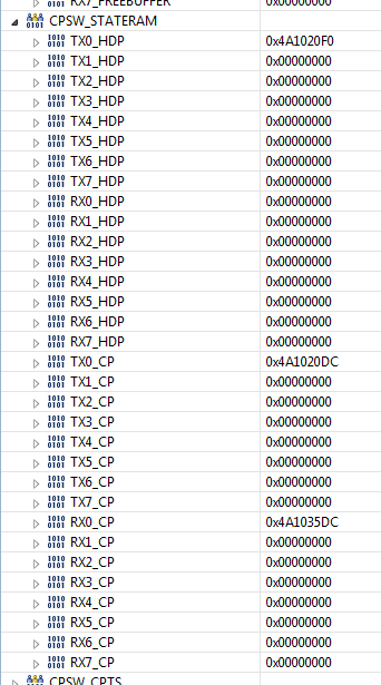

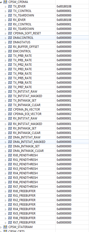

I have a problem with a stalling CPDMA/Tx interrupt when sending Ethernet data on a Sitara AM3359 custom board with custom firmware RTOS based.
Under heavy load the CPDMA stops sending and I don't get the Tx interrupt anymore. My test condition is about 200 ping consoles sending 1472 bytes each to the port. After some minutes or hours, sending stops but receiving goes on. I am not able to restart a transmission. The last package was finished by the DMA (e.g. HDP=0x4A102A8C, flags=0xE0000071 and CP=0x4A102A78, flags=0x1000003C, next=0x0) and the DMA_STAT is idle 0x80000000. Looks like I have a race condition here, but I followed the instruction of the TRM about the misqueued handling. I cannot see any error condition of the DMA.
When this happens I already tried a DMA restart by writing the TX_CP and TX_HDP again, disable and enable TX_EN, writing EOI_TX_PULSE again. No success.
My question: In which register can I see, why the CPDMA does not start again?
Stephan

    Here is a log example. I made copies of the whole transmit queue in the CPPI RAM when the descriptors are queued:
    Last Tx bd HDP=0x4A102924, CP=0x4A102910, flags=0x1000003C, DMA_STAT=0x80000000
    tx_bd_trace[115]=0x4A1028FC: flags=0xE0000074, next=0x0, buf_len=116, bufptr=0x8321C94E
    tx_bd_trace[116]=0x4A102910: flags=0xE000003C, next=0x0, buf_len=60, bufptr=0x8321C9E0 <<< This is the last send bd by the CPDMA
    tx_bd_trace[117]=0x4A102924: flags=0xE00005EA, next=0x0, buf_len=1514, bufptr=0x83CC9510 <<< This bd is not processed by the CPDMA anymore
    The last start attempt without response from the CPDMA:
    Last start attempt: HDP=0x4A102924: flags=0xE00005EA, next=0x0
    So from my point of view there is no reason why the CPDMA does not start sending the next HDP. Is there any other register I could observe?
    Stephan
  • Hello Experts,
    here are some test results which maybe give a clue to someone, where this problem is coming from.
    Here is another log output which is similar to the previous one. But I verified that the (not sent) packet from the IP stack is valid.
    Last tx HDP=0x4A102884, CP=0x4A102870, flags=0x1000003C, DMA_STAT=0x80000000
    tx_cp_trace[107]=0x4A10285C: flags=0xE0000071, next=0x0, len=113, bufptr=0x8321C94E
    tx_cp_trace[108]=0x4A102870: flags=0xE000003C, next=0x0, len=60, bufptr=0x8321C9C4   << This is the last sent bd by the CPDMA
    tx_cp_trace[109]=0x4A102884: flags=0xE000005A, next=0x0, len=90, bufptr=0x8321C94E   << This bd is not sent by the CPDMA anymore
      bd=0x4A102884: Ethernet header dest=fc4596aa29f, src=985dade42a20, type=8
    The Wireshark output shows, that the last sent packet by the CPDMA was 60 bytes. It is always an ARP broadcast to the other host. I don't know why this packet is generated before the transmission stops.
    This behavior is related to the CPSW switch configuration. I am using 2 ports as switch. One port is connected. The other port not. But one task is cyclically polling the Phy via MDIO to check if the other port is connected or not. By doing this, the MDIO auto negotiation and status registers are read. Once the second port is connected, the problem disappears. So somehow the MDIO communication seem to cause this problem.
    I am grateful for any hint.
    Stephan
  • Please, check unconnected port state in ALE - it must be disabled.
  • Hi Stephan,
    Discussing internally here are a few suggestions:
    1) If you have not looked already, we recommend looking at the Linux cpsw and cpdma driver source files. You can download the latest TI SDK and after installing (assuming you have a Linux machine) take a look at drivers/net/ethernet/ti/cpsw.c and davinci_cpdma.c. If you don't have a Linux machine you can search on the web for these file names, there are online kernel source trees that can be viewed.
    2) When writing to HDP you need to check:
    "Writing to these locations when they are non-zero is an error (except at reset)." as per TRM
    3) For recovery he have to use teardown or reset - just writing to HDP wouldn't help.
    4) You need to ensure that the unconnected port is disabled in ALE, set to blocking.
    Schuyler
  • Hello Schuyler,
    thank you for the support.
    Seems like this solved the problem. Causing me headache for several month. I would never have found this out on my own, even if I wrote everything new.
    >> 1) ... take a look at drivers/net/ethernet/ti/cpsw.c and davinci_cpdma.c.
    Yes, I know the Linux drivers and always review them when I have problems. But the Linux drivers are very abstract and cannot be used as a firmware reference, except the developer is a Linux driver expert himself. In the davinci_cpdma.c I didn't find anything about ALE/PORT_STATE/BLOCKING. More helpful are the u-boot drivers. But the features are limited.
    Yes, I checked and indeed, when the transmission stalls, writing to HDP again doesn't help.
    So far I didn't try the Tx_Teardown. Maybe this would be a good workaround to get the port alive again. If the problem pops up again unexpectedly, I will try this.
    Stephan
