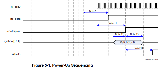

I have question about the AM5728 power up sequence.

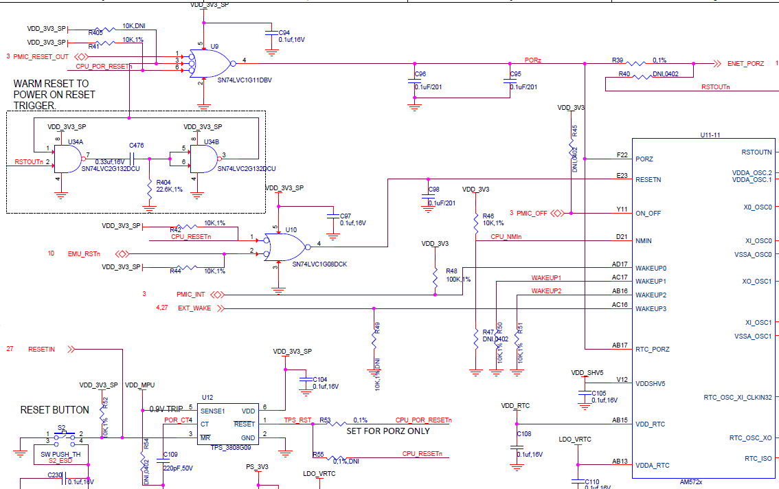

In AM572xEVM, RESET_OUT of PMIC is connected to PORZ and RTC_PORZ on AM572x device.
But it is described in the datasheet that RESETN and PORZ are released at the same time.
Is it OK to release PORZ and RTC_PORZ at the same time as AM572xEVM?
Is it OK to release RESETN before RTC_PORZ?
