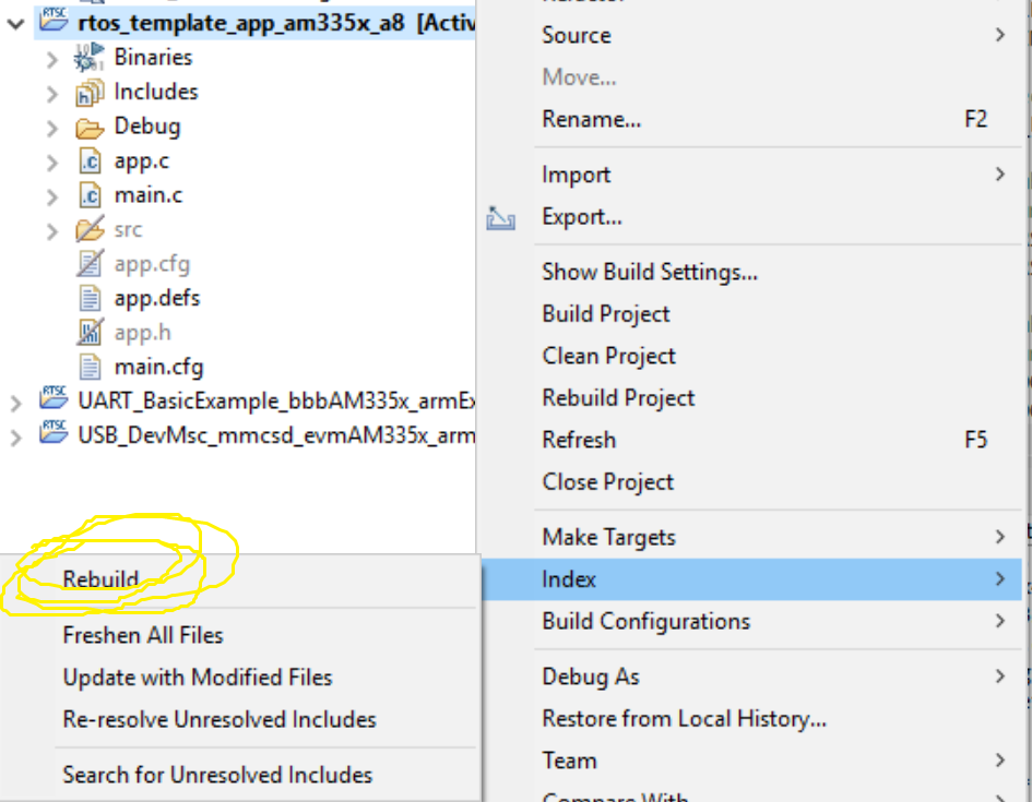

Good day,
I have been trying to get multiple peripherals running on a BBB using Processor SDK TIRTOS and was informed that a new, slick demo was available in the latest "processor_sdk_rtos_am335x_4_02_00_09".
I downloaded, installed everything and even have some PDK examples built and running on the BBB.
When I tried to pull in the "rtos_template_app" that is included in the processor sdk folder as instructed, it compiled great with the initial settings.
However, when i went in and changed the board to be a BBB in the General project settings in both the Project and Products tab AND updated my GNU Compiler symbol from "EVM_AM335X" to "BBB_AM335X", I get the following build errors (note that I removed my file structure to the workspace with "..."):

../app.c: In function 'i2c_eeprom_read_and_display_task':
../app.c:217:23: error: 'BOARD_I2C_EEPROM_INSTANCE' undeclared (first use in this function)
handle = I2C_open(BOARD_I2C_EEPROM_INSTANCE, &i2cParams);
../app.c:217:23: note: each undeclared identifier is reported only once for each function it appears in
../app.c:220:35: error: 'BOARD_I2C_EEPROM_ADDR' undeclared (first use in this function)
i2cTransaction.slaveAddress = BOARD_I2C_EEPROM_ADDR;
../app.c:225:45: error: 'BOARD_EEPROM_BOARD_NAME_ADDR' undeclared (first use in this function)
txBuf[0] = (char)(((uint32_t) 0xFF00 & BOARD_EEPROM_BOARD_NAME_ADDR)>>8);
../app.c:228:33: error: 'BOARD_EEPROM_BOARD_NAME_LENGTH' undeclared (first use in this function)
i2cTransaction.readCount = BOARD_EEPROM_BOARD_NAME_LENGTH;
../app.c:240:45: error: 'BOARD_EEPROM_VERSION_ADDR' undeclared (first use in this function)
txBuf[0] = (char)(((uint32_t) 0xFF00 & BOARD_EEPROM_VERSION_ADDR)>>8);
../app.c:243:33: error: 'BOARD_EEPROM_VERSION_LENGTH' undeclared (first use in this function)
i2cTransaction.readCount = BOARD_EEPROM_VERSION_LENGTH;
