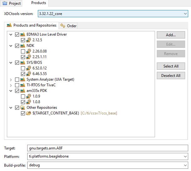

I am working on a BBB target and just recently switched to the Processor SDK TIRTOS 4_02_00_09.
In my code I have a 100hz task that is processing sensor data and a 1 hz task that is doing processor heavy updates.
The 100 hz task is higher priority than the 1 hz task.
When using  Processor SDK TIRTOS 4_01_00_06, my 100 hz task runs without missing a beat (I put a counter on the semaphore controlling the task and it was always 0 so I know it is being called fast enough).  My low rate task is running slower than 1 hz but that is a separate issue (the task priorities are working as I intended).
When using Processor SDK TIRTOS 4_02_00_09, my 100 hz task can't keep up!  My counter is into the 1000s and barely seems to be serviced at all and my 1 hz taks NEVER runs!
I am using identical code between the builds.
Here are the 4_01_00_06 Products I am building with:
Here are my 4_02_00_09  products:
Note that I did not actually have both SDKs installed when I found this issue but recently added them back in to verify what I was seeing.
Also, the main 100 hz loop is running SPI to read sensor data so SPI and GPIO (to control the chip select) are the only peripherals I am using on this build.

    If you used BIOS version 6.46.5.55 with your 4_02_00_09 environment, does it work then?
    Just checking if there are any deltas in behavior of your application between the two versions.
    Lali

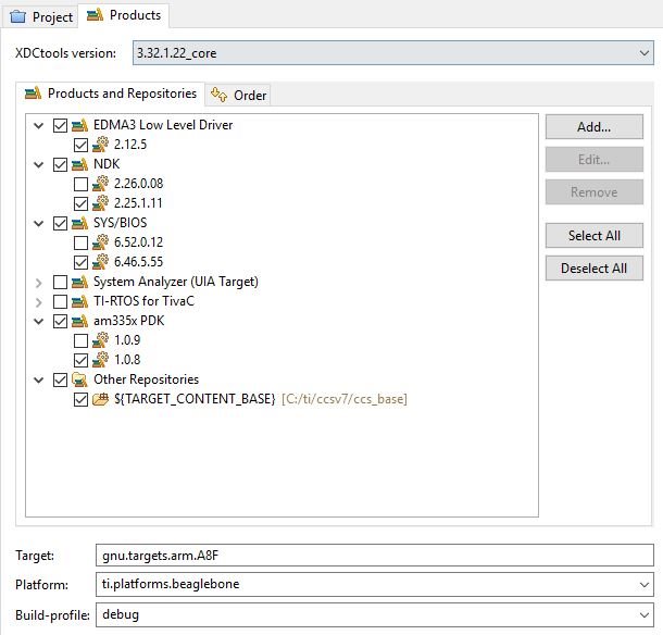

  • The project that is slow does not build with my 6.46.5.55 settings:

  • More information for you:
    As I mention above, one of the changes with the SDK change was going form GNU 4.9.3 (works) to GNU 6.3.1 (slow).
    I just built my 4.01 working program with 6.3.1 and it works but it seems to run my 1 hz loop slower – going from ~ 7 seconds with 4.9.3 to ~25 seconds with 6.3.1.
    I built my 4.02 sdk version with GNU 4.9.3 and it still doesn’t work (the 1 hz loop doesn't run).
  • Some more information for you:
    I built my working code with the new 1.0.9 PDK, 4.9.3 GNU compiler and the following other packages and my code runs:
    I then tried to build my program that was created from the SPI example made with 1.0.9 PDK projectcreate.bat (the program that has been running slow this whole time) to see if the above configuration works and I get the following build error:
