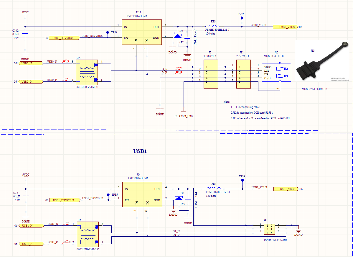

  • Since this is on AM335x EVM, the default DTS and kernel config in the Processor SDK should make USB1 work, why you have to modify DTS and re-configure kernel?
    Please test the pre-built images in the Processor SDK and let me know if you still see the issue.

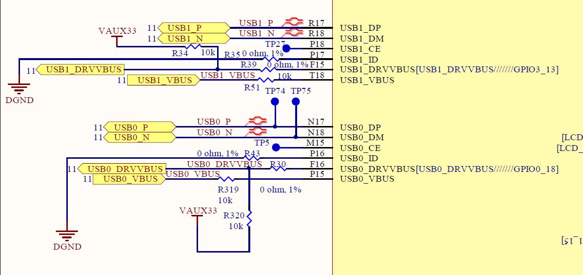

  • Hi Bin Liu,
    Sorry for typo, we are using custom board (not EVM)
    We are using custom am3354 board so we changed dts file as per the pin mux we used for our board.
  • The drvvbus pinmux you added in dts is not correct. You can simply remove them out of dts, the pin is in mode0 by default, you don't have to specifically set to mode0 in dts (I know it is a good practice to specify them even if mode0 is used...).
    Please post the usb portion of the schematics, including both usb0 and usb1.
  • Hi, I haven’t heard back from you, I’m assuming you were able to resolve your issue. If not, just post a reply below (or create a new thread if the thread has locked due to time-out). thanks.
    Sorry for late replay.
    Please find the below schmatic for USB.
  • TP74 and TP75 should be removed.
    Please post the rest of section of the USB schematics, including the connections to the USB receptacle.

  • Hi Bin Liu,
    Yes, we removed those Test Point though it is not working. I'm seeing the same issue with USB2 but USB1 is working fine.

  • Thejeswarareddy,
    The schematic you provided previously is not complete, I asked for the rest of section of the USB schematics, including the connections to the USB receptacle. Please post it.
    Thejeswarareddy R said:
    [ 395.808379] usb 2-1: new low-speed USB device number 2 using musb-hdrc
    [ 395.938418] usb 2-1: device descriptor read/64, error -71
    I assume you connected a high-speed usb device, but it is detected as a low-speed device. Can you please check your board layout in case the DM/DP lines got swapped?
  • Hi Bin Liu,
    The other part of scematic is attached below.
    Thanks in advance.
