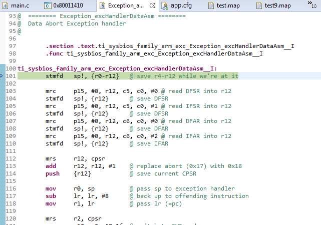

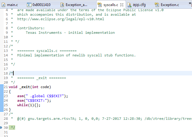

Let me talk about SYS/BIOS for AM335x on ICE board.
I want to just reset of GPMC module like this.
unsigned int baseAddr=0x50000000;
GPMCModuleSoftReset(baseAddr);
or
HWREG(0x50000000) |= 2;
But I got error after this line execution using this project.
test.zip
This project is just made like this.
It means new project
File -> new -> CCS Project -> SYS/BIOS -> GNU Target Example -> Typical ....
I add this line after this.
and I try this project.
C:\ti\pdk_am335x_1_0_9\packages\MyExampleProjects\GPMC_Test_icev2AM335x_armTestProject
I add this source
int main(void)
HWREG(0x50000010) |= 2; <- I add
But I did not get error in Processor SDK Project.
Why does new project got error ??
