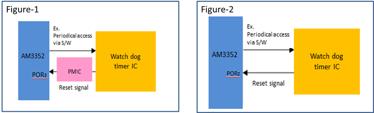

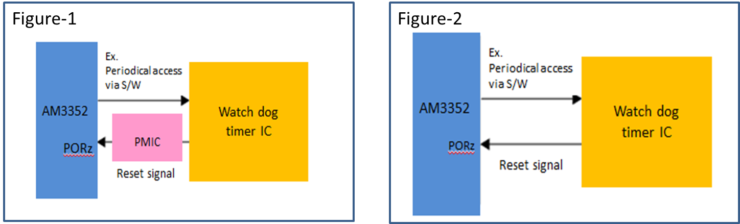

    If AM335x is triggered to reset completely by the external WDT during Active mode,
    does it need to connect to the PORz on AM335x via PMIC such as "figure-1"?
    Or can it be connect directly to PORz on AM335x such as "figure-2"?
    If it must connect to the PORz via PMIC, the PORz input voltage for the complete reset will be 0V by PMIC.
    If it can connect directly to the PORz, the PORz input voltage for the complete reset will be 0.5V
    that is the VIL max. value of PWRONRSTn in the datasheet.
    Is my understanding correct?
    Kanae
  • I understand now. Figure 1 seems the better option, since when you reset the PMIC it will restart at default voltages. If you want to use Figure 2 it will be better to connect the WD reset to nRESET_INOUT, since this will only reset the processor (of course in this case the WD must be able to issue a low-level pulse, and not hold the line continuously low).
  • Hi Biser,
    Thank you for quick reply!
    I would like to make sure what you meant.
    1. If I want to reset completely, I have to connect "WDT IC" to PORz of AM3352 via PMIC.
    2. If I connect directly "WDT IC" to AM3352, it should connect to nRESET_INOUT of AM335x as "Warm reset".
    However "Warm reset" is not able to reset completely.
    Based on the above my understanding, I should choose the figure-1 connection for the complete reset.
    Is it correct?
    Kanae
  • Yes, this is correct.
