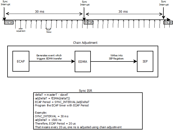

    Regarding the PTCP clock compensation method:
    PRU firmware receives and forwards Sync and follow up frames from dedicated buffers. Sync ISR triggers clock synchronization. PTCP design for SoC platforms such as AM335x and AM437x uses ECAP, EDMA, IEP chain for clock synchronization.
             MasterT = Torg + line_delay
             LocalT = RXSFD of received sync frame
    deltaT is calculated as
             deltaT=MasterT-LocalT
    Filtering is applied on deltaT to get clock drift
             adjDeltaT = simple moving average of deltaT values
    Over one sync interval, the IEP counter is compensated by adjDeltaT.

  • Hi Nathan,
    >>the target register of reconfiguring eCAP seems in SoC level in stead of PRU-ICSS
    It's true that the target register of reconfiguring eCAP is in SoC level.
    Currently there is no plan to support SOC eCAP functions on AMIC110. However, your inquiry has initiated a discussion to review this decision and we will update this post once the discussion is complete.
    Garrett
  • TI has decided to support SoC level eCAP functions in AMIC110. This capability will be updated in the next revision of the AMIC110 Data Manual.
