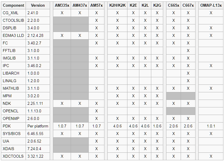

From a brand new setup with a do nothing application I keep getting the following error message when I drag the MessageQ into the DSP BIOS.  If I remove MessageQ then it builds fine.
I've looked up compatibility on the chart and it says BIOS 6.53.02.00 is compatible with XDCTools 3.50.03.33 which are in use here, so what is the issue with adding the MessageQ Module?

error: xdc.cfg.Program: "C:/ti/xdctools_3_50_03_33_core/packages/xdc/cfg/Program.xs", line 71: xdc.cfg.Program : The package 'ti.sdo.utils' is not compatible with XDCtools used in this build. Please either use XDCtools compatible with that package, or update the product containing that package, or rebuild the package with XDCtools 3.50 or later.
