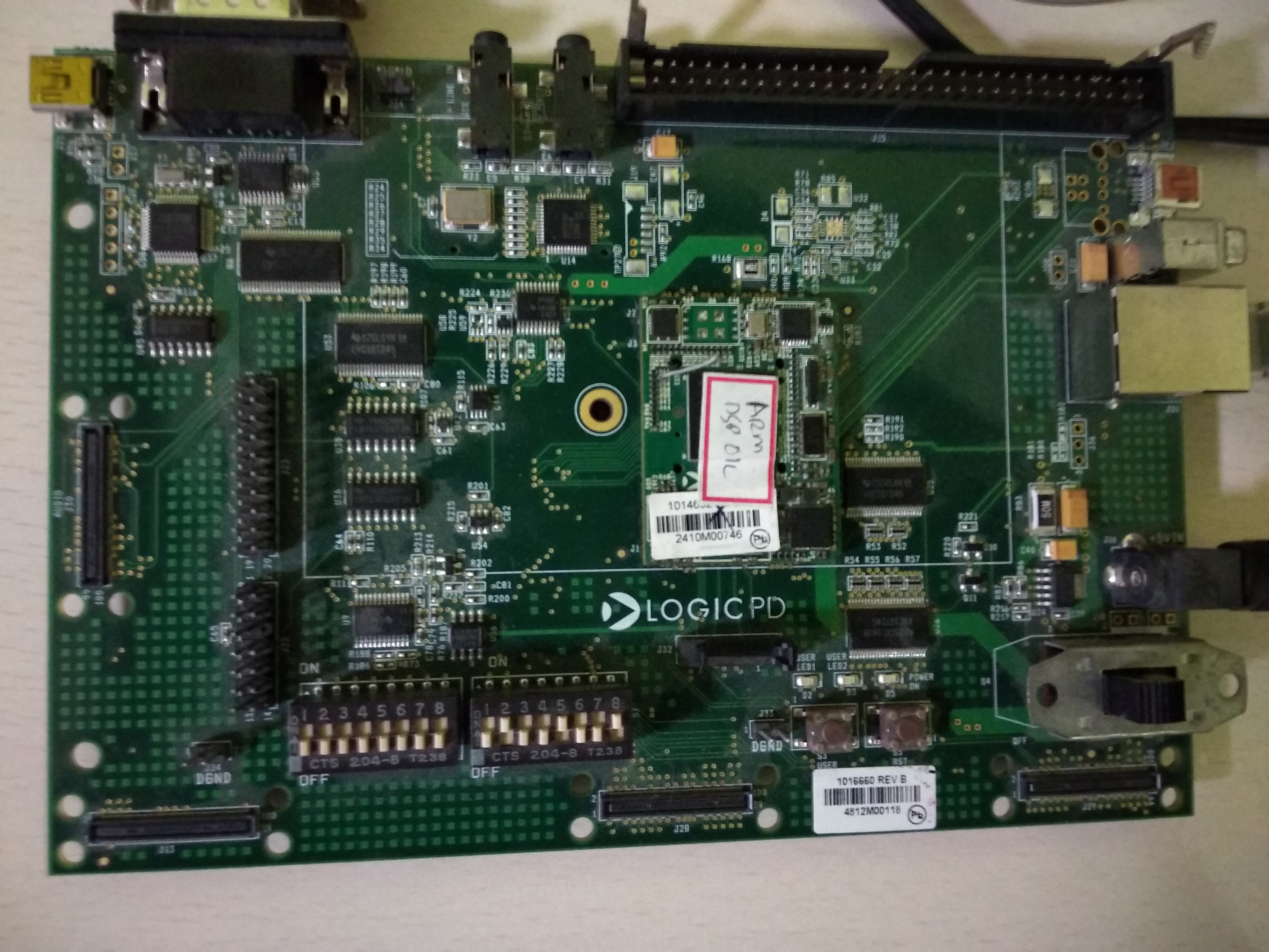

I am Using EVM OMAPL138 Development kit for Ethernet Interface between PC and Development Kit..I extracted the whole project from TI's official site.(From OMAPL138_StarterWare_1_10_04_01 /build/armv5/cgt_css/omapl138/evmOMAPL138/enet_lwip).But the PHY LAN8710a fails to acknowledge the access while reading ALIVE status register using MDIO bus.How is it resolved????

  • Hi Arun,
    Can you confirm that you are using the OMAP-L138 EVM and NOT the OMAP-L138 LCDK (shown below)?
  • Hi sahin,
    The board i have been using is attached above.This is EVM Omapl138.
    Arun kumar

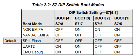

  • Hi Arun,
    I have not been able to reproduce this issue with the board I have here. Have you made any changes to the example code? Are you seeing anything over UART either before/after changing to static IP?
    Also, make sure your DIP switches are set to the "EMU Debug" configuration as shown below when loading over CCS.
  • Hi sahin,
    Thanks for your reply.
                 DIP switches are set to the "EMU Debug" configuration in my board.U can see in my development board that i have attached above. Can u please conform is there any switches for enabling lan8710a in development board.
    Regards.
    Arun kumar
  • Hi Arun,
    There aren't any switches on the EVM for enabling/disabling the PHY. Can you confirm that you have not made any changes to the example?
  • Hi Sahin,
    Finally the problem is solved. some hardware problem in my SOM chip. Anyway thanks a lot for your valuable replies.
    Arun Kumar
