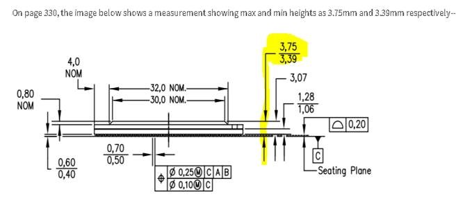

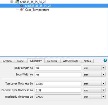

In thermal model we have total body thickness as 2.975mm and in the datasheet it is given as (3.75max  and 3.39min).
Which one is correct?
Attached are the snap shots of thermal model and the datasheet showing the difference in the thickness.
thermal model read me file contents as below
The attached models are property of Texas Instruments and provided without warranty.
These models are subject to change without notice, please confirm that you have the
latest models with respect to the release of your DSP.
The thermal model within this compressed file support the following DSP(s):
 TCI6638K2K
 TCI6636K2H
 TCI6634K2K
These models are provided without warranty.
The models contained within this compressed file are suitable various power configurations and should scale properly within the allowable configuration limits.
It is the responsibility of the end user of these files and application hardware to assure that each device does not exceed the allowable thermal conditions established and documented within each respected application note or data manual.
When no data manual exists, the maximum allowable junction temperature shall not under any condition exceed 100°C!
Failure to comply with this requirement will reduce device reliability and void any device warranty.
As always, refer to your data manual for absolute maximum operating conditions.
The following resistive values are provided for reference purposes only for the for the TCI6638K2K, TCI6636K2H, TCI6634K2K DSP models.
++Delphi Model++
Node i   Node j  Resistance (K/W)
Top Inner  Bottom Inner 5.100000e+000
Top Inner  Top Outer  1.030000e+000
Top Inner  Bottom Outer 4.066489e+001
Junction 1  Top Inner  1.100000e-001
Bottom Inner Top Outer  5.039149e+002
Junction 1  Bottom Inner 1.600000e+000
Top Outer  Bottom Outer 6.300000e+000
Junction 1  Top Outer  1.050000e+001
Junction 1  Bottom Outer 2.100000e+000
Junction 1  Package Side 1.860000e+000
++2R Model++
Junction Top  1.100000e-001
Junction PCB  1.650000e+000
    In case of differences you should refer to the Datasheet, as it is the most regularly updated document.
    I am looping the hw team to confirm.
    Yordan
  • HI,
    The TCI6638k2k datasheet does not give the package height/thickness in the package drawing.
    Could you please help us get the minimum, nominal and maximum value of the package height for version 3.0 and version 2.0 of silicon.
    We are referring AAW1517B_ePOD.pdf document for the version 3.0 silicon, however this does not specify a nominal and minimum package height. Please help us with the requested data
    Shiladitya
  • HI,
    I am still awaiting a response to this. Please guide me as to which page in the TCI6638K2K datasheet the package info is given
    I have the following confusing info
    TCI6638K2H datasheet, page 330 mentions a max height of 3.75mm
    AAW1517B_ePOD.pdf mentions a max height of 3.62 mm
    I have also read that the package height is different across different silicon versions of K2K
    Please provide us with the accurate info on package height
    Shiladitya
  • HI
    an additional question to my previous post
    AAW1517B_ePOD.pdf mentions a max height of 3.62 mm but doesnt give a min height. Can we assume a 0.18mm tolerance and thus
    3.62 mm is max height
    3.44 mm is nominal height
    3.26 mm is min height
    Shiladitya
