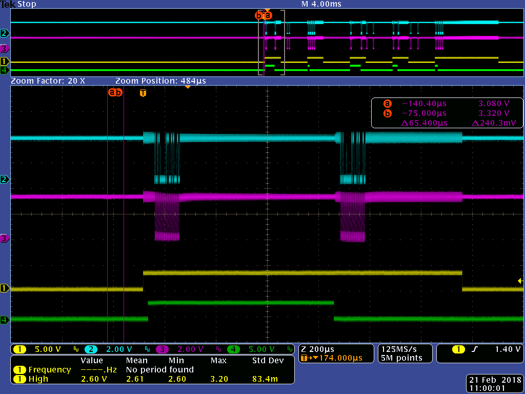

The interrupt latency of the GPIO8 ISR on the IPU is around 500uS to 700uS which is way to long. Enabling IRQ1 and IRQ2 of the GPIO8 as described as workaround in the e2e thread linked above does solve the latency issue but causes the I2C transfers to be very slow: after (almost!) each transfer there's an additional delay. Some transfers are still fast back to back. I've got one on the scope screen shot below. Most of them are slow. A mix of slow/fast also happens.

I measured the I2C transfers:
Channel 1: trigger on GPIO8_20
Channel 2+3: I2C bus 3
Channel 4: GPIO4_4 to measure the time of a single i2c transfer
SLOW:
FAST:

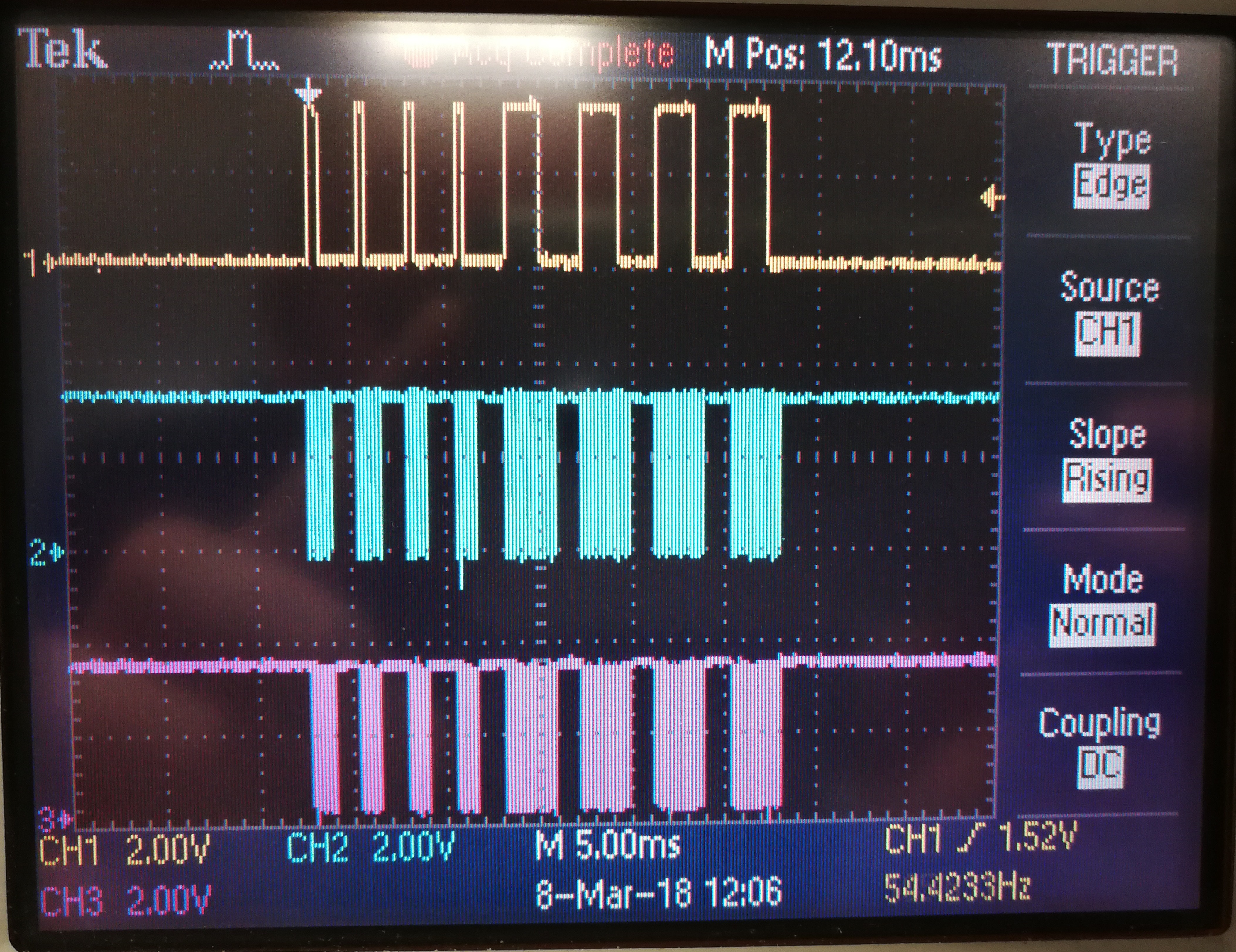

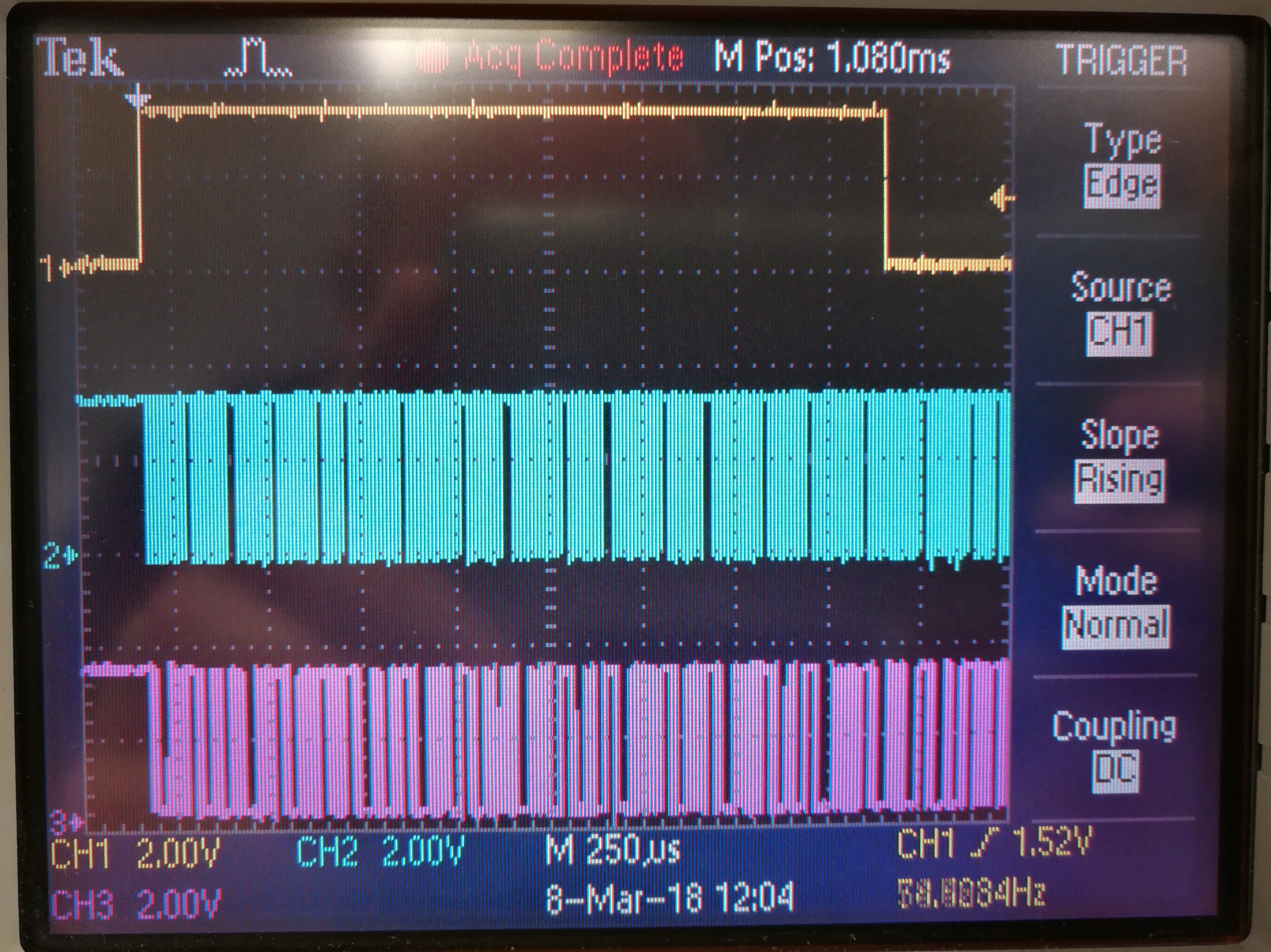

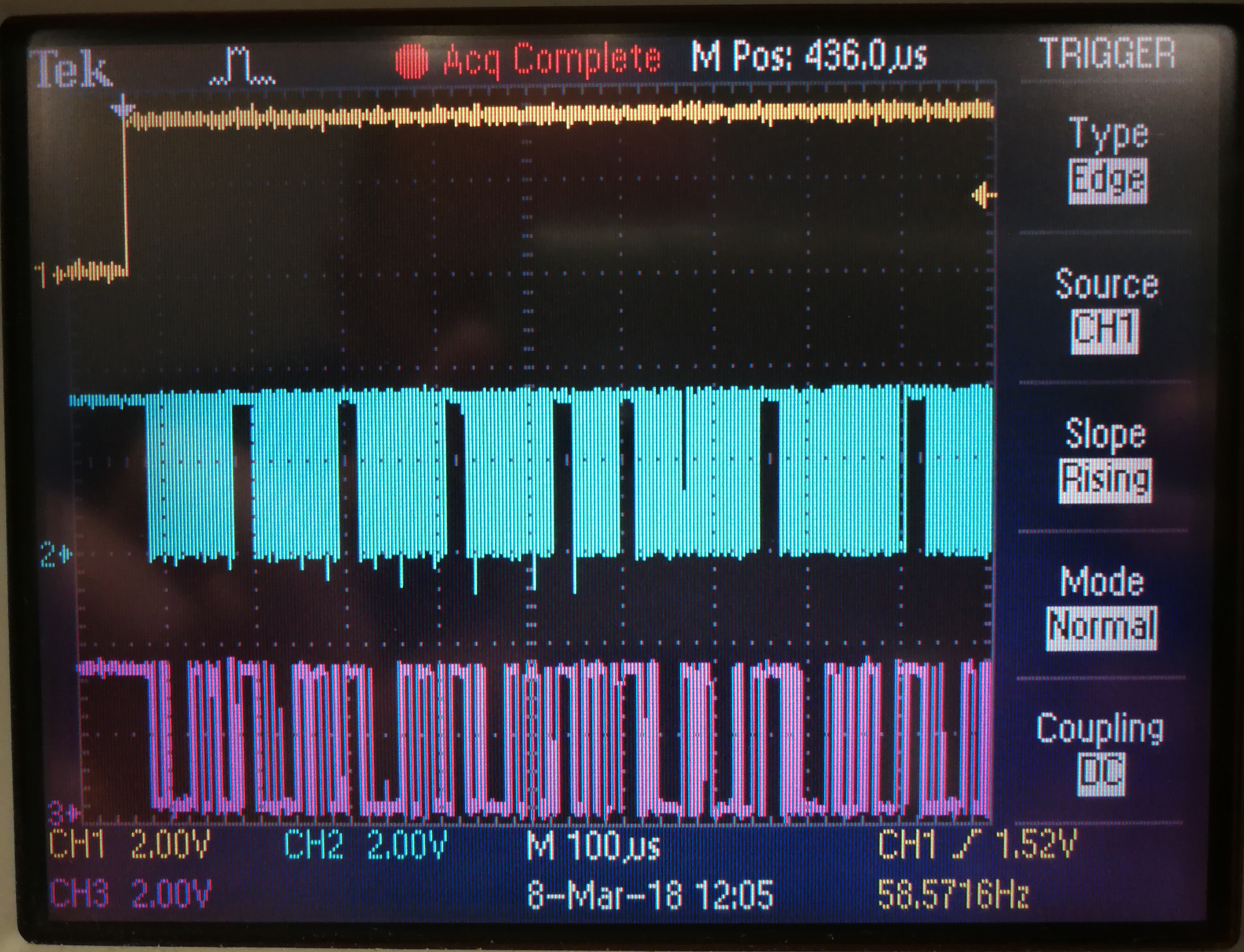

    I can provide some screenshots taken by an oscilloscope during a standalone execution running on IPU under TI RTOS using TI's pdk driver (no bare-metal version):
    this is an overview during 8 pulses of GPIO8.20 (in yellow) and the following are more detailed pictures:
    As you can see I2C transactions are completed before the next rising edge of GPIO8.20 and everything is running in the contest of an high priority task pending on an event posted by the callback of GPIO isr.
    I have other traces showing mainly the latency of I2C activity compared to GPIO interrupt that I can summarize in the following way:
    1) Bare-metal I2C driver + ISR  (it means a call of a subset of I2C transactions in ISR): latency ~ 3us
    2) Bare-metal I2C driver + SWI : latency ~ 9us
    3) TI's multi-thread safe I2C driver + high priority task (handler task) : latency ~ 14 us
    In any case, under TI RTOS without Linux+IPC, I never saw problems reported by Lo2.
