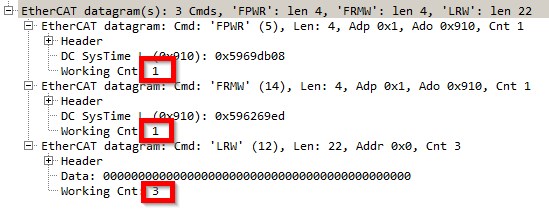

we are using the PRU-ICSS-EtherCAT_Slave on AM3357 within our servo inverter.
The design is originally based on the code from TI but has been substantial functional enhanced over the years.
The device works since two years without problems by a number of customers with several masters like TwinCAT, Acontis, 3S and some more.
Now one of our customers insist on using the servo inverter with the IgH master and found serious communication problems.

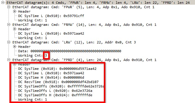

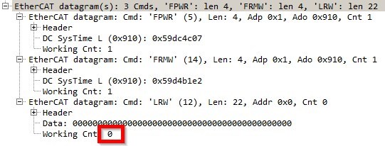

We reproduced the problems with IgH EtherCAT master v1.5.2 and are experiencing a PRU hang up problems.
We checked the master configuration and come to the conclusion, that this is a internal PRU problem.
As soon as the master configured SM2/3 and the FMMUs and starts setting the DCcycle times the communication breaks down. Even reading the SII EPROM or mailbox communication is broken.
This behaviour can be seen at the attached master log:

The slave stack is up to date (PRU-ICSS-EtherCAT_Slave_01.00.05.00) and TI-ESC reports build 04EC.
We asking the EtherCAT team to have a look at the attached wireshark log (and the master log) to identify and hopefully solve this issue.
Thank you.

    When examining the communication log I found that point where the communication broke down.
    One packet before the system time is tuned every thing is working fine:
    Then system time is tuned (communication is still working see WKC==3):
    Few ticks later the communication breaks down finally and do not recover:
    I can actually not imagine how my high level code like space vector PWM and position / velocity controllers running on A8 can force the PRU - an independed processor - to break down the communication when the system time is tuned by the master.
    It seems more likely that there is an incompliance between master and slave (PRU).
