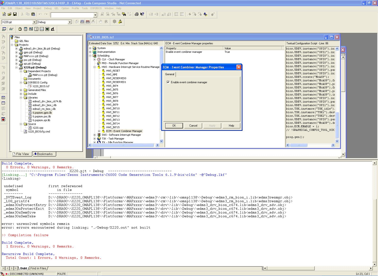

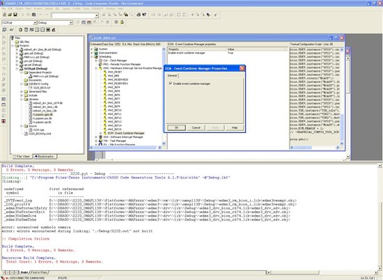

  • ECM_dispatchTab is an option of the tcf file, the problem is that I don't remember now where is it exactly, look in the DSP/BIOS file configuration to find it. If you can't find it just add this as text to your tcf file:
    bios.ECM.ENABLE = 1;
    EDIT: ok, I have found it, is in HWI module-> ECM: Event combiner manager. Right click and click on checkbox to enable ECM.Would this worth a pint of beer??? :)
    Cheers
  • You can do this in the graphical config by right clicking on ECM in HWI tree and selecting to enable it in the properties.

    I have the same problem. I've followed your instructions to enable the ECM in the bios but didn´t result ....
    [Linking...] "C:\Program Files\Texas Instruments\C6000 Code Generation Tools 6.1.9\bin\cl6x" -@"Debug.lkf"
    <Linking>
     undefined            first referenced
      symbol                  in file
     _DVTEvent_Log        D:\\DRAGO\\X220_OMAPL138\\Platforms\\MAPxxxx\\edma3\\rm\\lib\\omapl138\\Debug\\edma3_rm_bios_i.lib<edma3resmgr.obj>
     _LOG_printf4         D:\\DRAGO\\X220_OMAPL138\\Platforms\\MAPxxxx\\edma3\\rm\\lib\\omapl138\\Debug\\edma3_rm_bios_i.lib<edma3resmgr.obj>
     _edma3OsProtectEntry D:\\DRAGO\\X220_OMAPL138\\Platforms\\MAPxxxx\\edma3\\drv\\lib\\Debug\\edma3_drv_bios_c674.lib<edma3_drv_adv.obj>
     _edma3OsProtectExit  D:\\DRAGO\\X220_OMAPL138\\Platforms\\MAPxxxx\\edma3\\drv\\lib\\Debug\\edma3_drv_bios_c674.lib<edma3_drv_adv.obj>
     _edma3OsSemGive      D:\\DRAGO\\X220_OMAPL138\\Platforms\\MAPxxxx\\edma3\\drv\\lib\\Debug\\edma3_drv_bios_c674.lib<edma3_drv_adv.obj>
     _edma3OsSemTake      D:\\DRAGO\\X220_OMAPL138\\Platforms\\MAPxxxx\\edma3\\drv\\lib\\Debug\\edma3_drv_bios_c674.lib<edma3_drv_adv.obj>
    error: unresolved symbols remain
    error: errors encountered during linking; "./Debug/X220.out" not built
    >> Compilation failure
