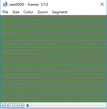

        And i still have another question about the software tool to open the RAW file. I have downloaded a YUVPlayer to open it, and the result is like this:
         As you see this is not the image we want. I think the dumped frame is good, but my viewer is not correct. So what RAW file viewer should i use?
    xuanbo
  • Hi xuanbo,
    Great, that's good news. Do you also see frame counter incremental?
    We use IrfanView tool to view raw bayer images. This tool is freely available. Please note you require to install additional plugins to view raw bayer images.

  • Hi Brijesh
    I found the proper RAW viewer to see the dump frame file.
    Thank you for your help all the time. You are a very good "teacher".
    xuanbo
  • Hi Brijesh
    After i change the setting of YUV Viewer, it is one frame image, and i did not see any frame counter incremental any more.
    xuanbo
