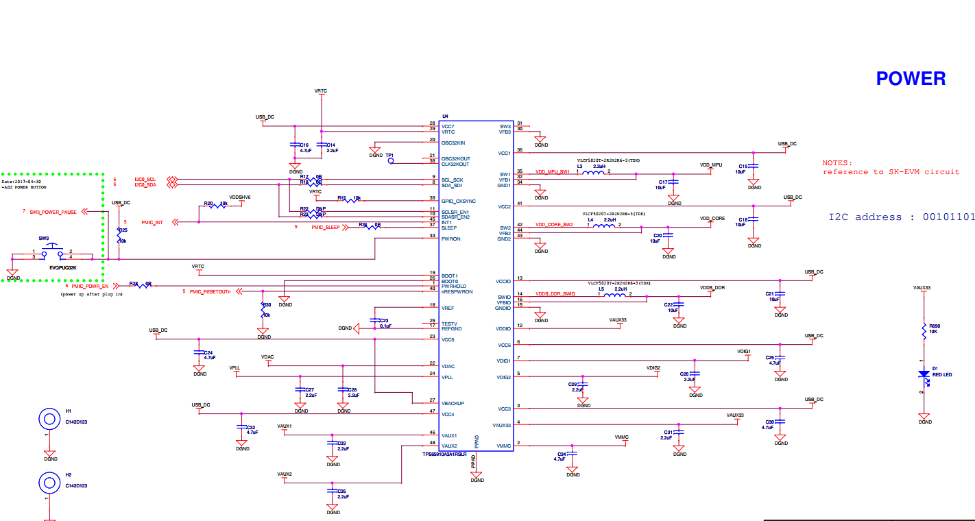

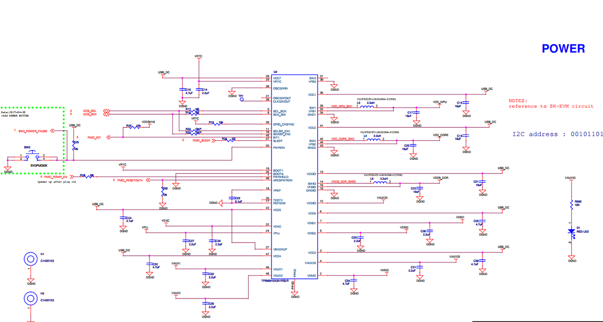

  • Please post the entire PMIC section of your schematic.
  • Following is TPS65910 schematic

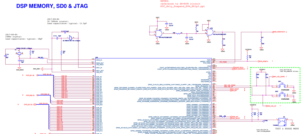

  • From where is the AM335x RTC powered? How do you provide the RTC reset signal?
    VRTC from TPS65910. Following is RTC_PORz schematic
  • Following is my understanding.
    1.First time power on : RTC_PORz schematic will reset RTC_SS of AM335x. The PMIC_POWER_EN will drive high.
    2.After ALARM2 power off AM335x and TPS65910 (except VRTC). The toggle of POWERON(TPS65910) will transit TPS65910 state machine to READY ( POWERON LOW) and power on AM335x.
      Second time power on will not reset RTC_SS, and PMIC_POWER_EN will not drive high as initial state.
    And We try some experiment in boot loader (uboot). Hope to reset RTC_SS manually or drive PMIC_POWER_EN high.

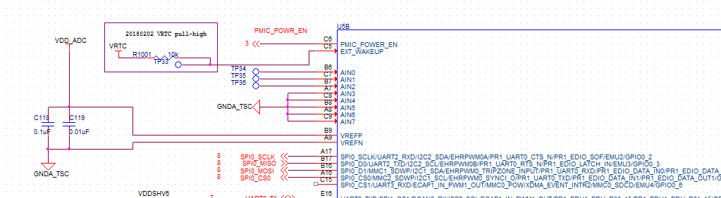

  • I don't understand what modifications you have made. Please post the corrected schematic.
  • Following is schematic.
    I connect VRTC with 10K resistance to EXT_WAKE. After power off by ALARM2. The power button still can't power on continually.
    And I add code at u-boot to set RTC_PMIC register and we get strange result in previous post.
    RTC_PMIC = 0x1; // enable ext_wake0
  • Try connecting the power button to EXT_WAKEUP too. Be careful with the different voltage levels on PMIC and processor side.

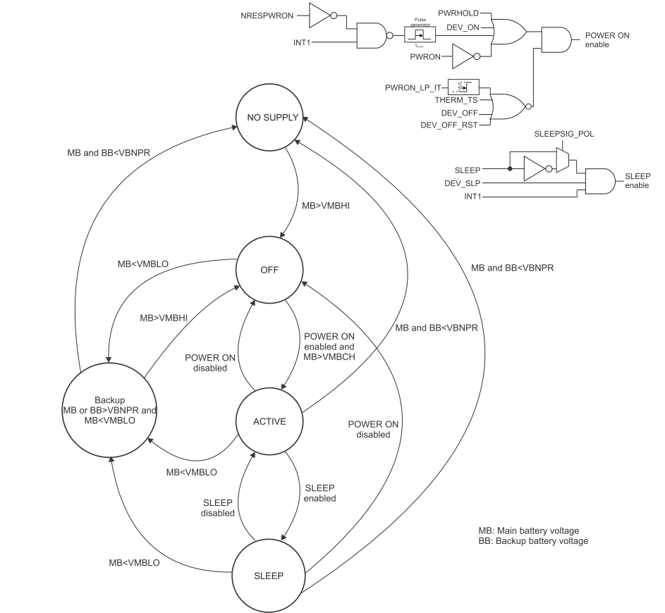

  • We pull down EXT_WAKEUP( connect to GND manually). But still can't power on TPS65910 after second time power off.
    According following state-machine , we check PWRHOLD(1.8v) ,  PWRON ( low active), DEVCTRL = 0x70.
  • We find the problem. I will explain later.
