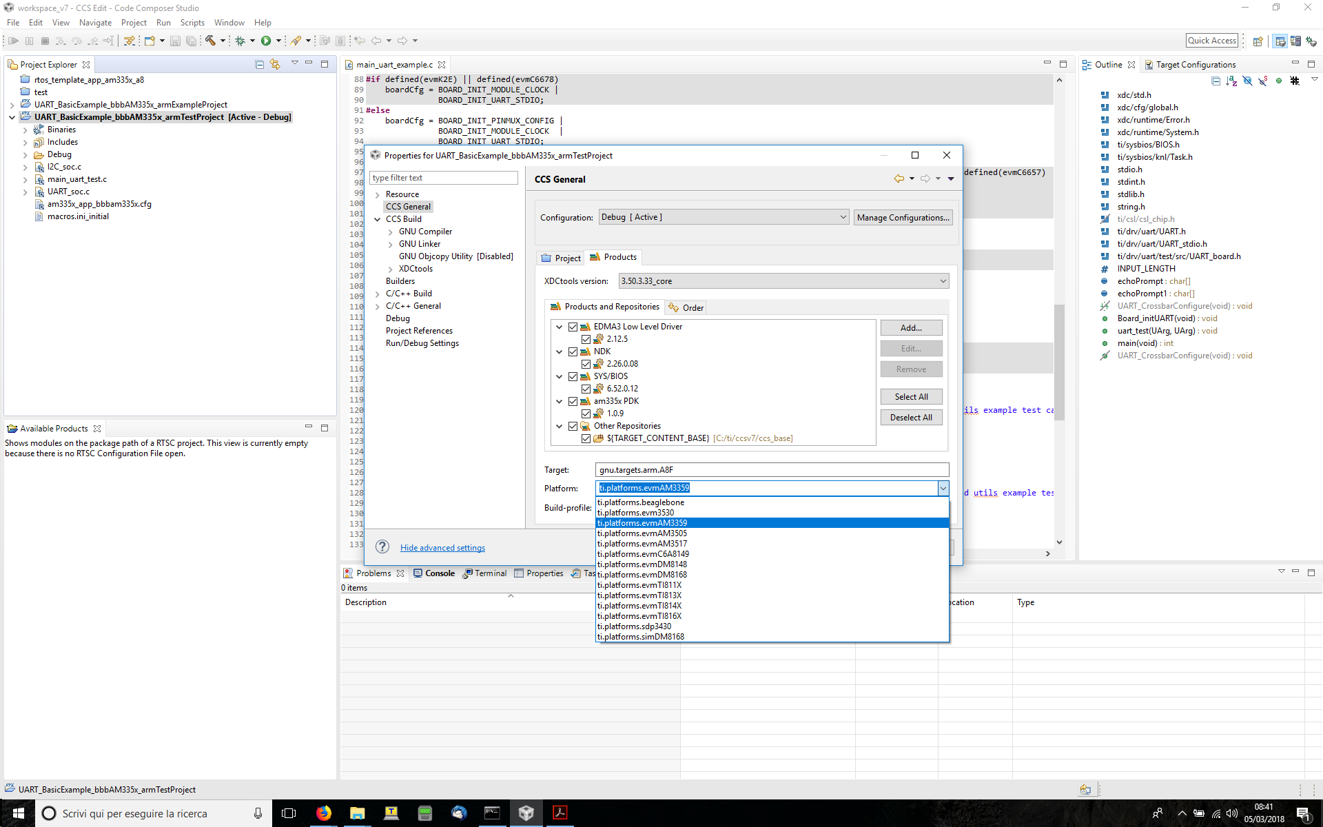

    I've discovered that the beaglebone black platform doesn't exist.
    In fact, even though I've chosen bbbAM335x as board for generating the example, the project is made for ICE_AM3359.
    I'll try to write a custom platform for Beaglebone Black. Please, at least, advise me if you have one ready to download.
    Thank you.
  • David,
    The BIOS platform is not created for all TI evaluation platforms. The intent of creating a platform in the BIOS is to provide the memory section definitions, Cache configurations and initial core setup. The evmAM335x or iceAM335x platform can be used for other TI evaluation platforms to create a TI RTOS project and can be used on beagleBone black as well as you can see from the PDK examples provided for beaglebone black platform.
    When you pick this platform the linker and compiler will pull in the cortex A8 specific compile time flags and will know pick the OCMC and DDR memory definitions for the SOC from that platform definition.
    Rahul
