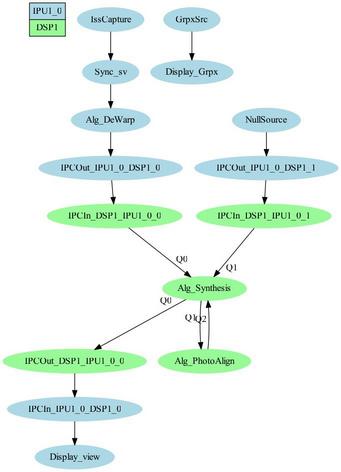

Hi.
I have camera module that include ISP.
So don't need ISP in TDA3x.
I change 3d sv use-case as follows.
But 3D surround view don't display normally.
Especially, left and right camera.
Left Camera Examples)
Cone on left camera image looks same even though angle changed.

  • Hi Sujith.
    I used calibrated CALMAT.bin. But didn't install camera to jig yet.
    So, I understand misalinment.
    I think that left (and right) camera image is changed according to the view angle.
    Especialily, first and second yellow cone looks same even though view angle was changed.
