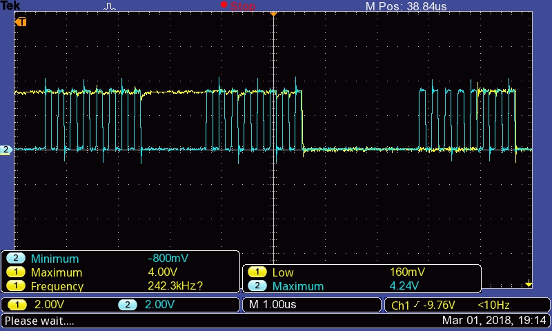

  • No I am not checking SPIFLG register before calling the transmit and receive functions. Is it really required?
  • Hello Norman Wong ,
    Thanks for your response,
    I used the above code still I am not getting the return value in spiRecieve() function. In the scope picture u can see the SCK and MISO lines. Iam getting the value in 3rd cycle. I have attached the registry values also.
    I am interfacing Tms320C6748 with MCP2515 through SPI0. The value I am getting in MISO line which I see through scope is correct. But I am not getting this in the SPIRecieve function.
    Also I checked the SPI0_MISO by configuring it as GPIO8[6] and given GPIO output HIGH and I could see the HIGH value in scope. By this I can confirm the value reaches the SPI0_MISO pin of the DSP.
    I dont know what I am missing.
    Kindly help me in this regards.

  • The code look okay. You should comment out this line when using polled IO.
    SPIIntLevelSet(SOC_SPI_0_REGS, SPI_RECV_INTLVL | SPI_TRANSMIT_INTLVL)
    SetUpInt();
    Otherwise, the interrupt code and polled code could fight with each other.
    The scope trace mostly okay. I am surprised that the DSP is so slow that there are gaps between each word. You might have switch to DMA to get continous transfer. I can only think that the external MISO pin is not PINMUX'ed to the internal MISO of the SPI controller. Check the PINMUX setting for that pin.

  • When you use the unchanged original interrupt driven code, to you get the same results? If the interrupt code works, then the PINMUX has been configured properly.
    In polled IO, did you comment out all the interrupt code?
  • I tested the same code in another LCDKC6748 board and found  RXDATA of  SPIBUF registry gets the MISO value as we see in the scope.
    RXDATA    0000000010000111    Receive data
    But the array variable rx_data[2] where the return value of SPIreceive() function is to be stored is showing 0xFF.
    Thanks & Regards
    Navaneetha krishnan
